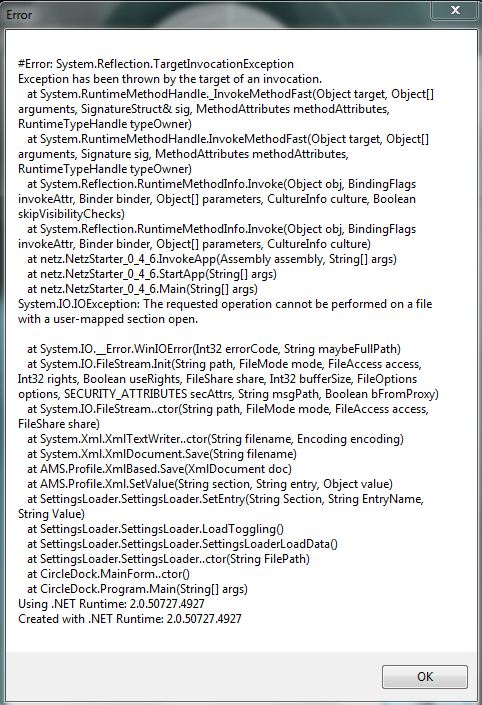

I just got an error with my circle docks after i turned behave like .9 and portability options off

The reason you are having problems and triggered that error is that all your instances are installed in System-protected folders and they are all trying to access the same configuration files.
Try installing each instance into a non-System-protected folder, such as C:\CircleDock 1 ...

I had to use a timer because if the docks were all started at the same time I'd get an error...
Also found out that you have to start your last instance first, if you do it from fist instance to last you'll get an error...

Regardless of the order in which you start them, the instances will be numbered (identified) in the order in which they are started. If you load the main settings dialog for the instance loaded from "C:\Circle Dock1", the dialog's caption should include the phrase "Instance 4 of 4".
And yes, you will need to include a delay between loading each instance to allow for each instance to load, initialise itself and begin processing (Windows) messages.
