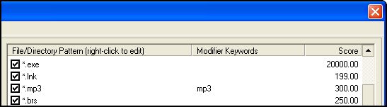

If FARR doesn't already have a way to filter search results by file type/extension, then it totally should...
Ok so I just went and looked at preferences, and I suspect there may be an existing setting to do what you want. Go to Preferences->Lists->Pattern Scoring. Check out the *.exe entry and consider its score...
- Oshyan

Well, that doesn't exactly work.  I don't necessarily want my exe's to be worth so much more than my lnk's, because in my start menu, many of the lnk's are equivalent to exe's in that they run programs.  But I want the non-program launching lnk's to be worth very little, but I still want the portable exe's to be worth a lot.
