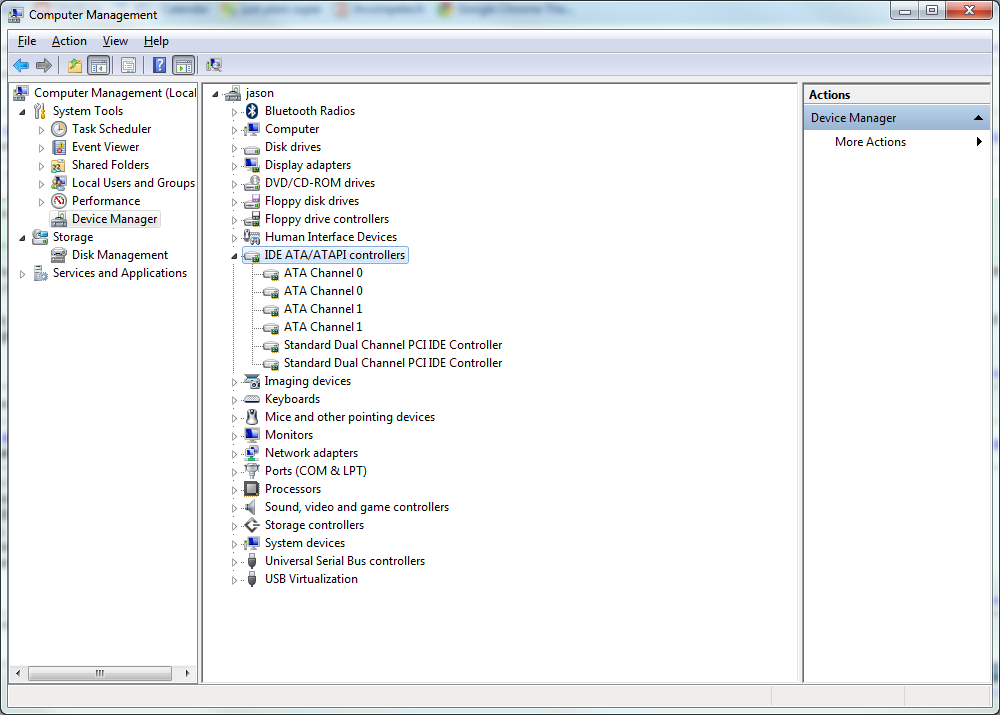

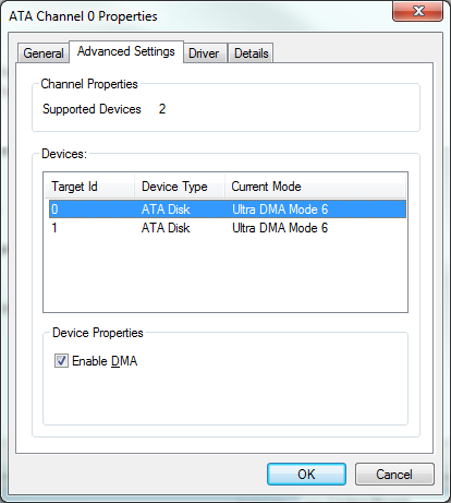

I've never heard of dma mode or pio mode, so I don't know for sure if my hard drive is running in dma or pio, but I did run across something that I thought looked like something useful.
That is the closest thing I got to any dma/pio settings
those are the only devices under the ide ata controllers, and I attempted to update all of them through the windows update, but they were all up to date.

nite_monkey: those are the settings - if ALL of the controllers are in UDMA mode, then it's not the dma->pio failure, and probably (though not guaranteed!) a failing drive.
If the freezes only happen while playing a game, it could be your GPU overheating...
