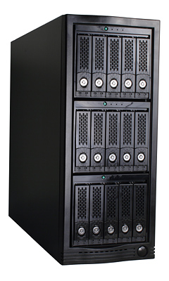

Re: Building a home server. Please help, DC!
« Reply #156 on: September 08, 2011, 05:40 PM »
OK, I went back and reread this thread (ping-pong is exactly the correct term!).  But that's how I work, sorry if it's frustrating.  Believe it or not, all of this helps me a lot, and I appreciate everyone's assistance.  Good will come of this, I promise!
So I went back to some of the previous links, and the product I'm really liking is this one:
This will be my box of drives.  This box will be directly connected to my current workstation through these SAS cables (which I don't know much about right now).  But it sounds perfect.  I'll need to buy a SAS controller for that box, which are relatively expensive.  I think this is the item that a few of you here have talked about to make sure I get a business grade quality, which I want to do.  If you have any advice as to which manufacturer/model I should get, please let me know.
Next is the connection to my computer.  My computer doesn't have any SAS stuff right now, so I'm guessing I need to buy a card or something for it.  Any direction on suggested models would be appreciated.  Same goes for any cables involved, in case I have to be careful about it.
So that gets mucho storage attached to my desktop.  After that, I can experiment to my hearts content.  I'll try doing some server stuff with VM's.  But mostly I'll just use the storage directly from the desktop.
How is that?  I can't really see much overkill in this one, and it's relatively cheap.  The box and related items will run me about $1500, and then I'll just hunt around for good hard drive deals.  The ones with 5 -year warranties are my fav.

Hi superboy, have u checked the pricing on 2TB SAS drives? I think that's one important step before you commit to buying that big box.
Agreed, but one good point of this route is it IS backward compatible with SATA.  I don't know how WELL it is compatible, but they will work with drives at least.
I will absolutely not consider USB as the connection, nor will I consider firewire.  I like esata very much.  I'm hoping there's a better way with some kind of card that plugs into a PCI bus or something.
I don't *think* anyone ever suggested USB or firewire.  I wouldn't consider anything less than esata, I know I wouldn't suggest it unless it were *MAYBE* USB3.0, and not even likely then.  As for DAS, I believe you are right in that being something very close to what you want.  I believe most DAS solutions provide a proprietary card that connects their solution to the machine making it essentially appear as another internal drive controller.  However, I have never really researched them or even know much about them so I can't guarantee that statement.  Also, I don't know that any of them allow you to build your own out of your own box such as that.
If you really want to roll your own SAN, there is a way to do it.  It will take a lot of time to get setup but you can do it in any form you desire.  You may even be able to build a DAS on it, I don't know.  It is using OpenFiler - a sourceforge project IIRC.  Don't know how responsive it would be compared to one you can just buy, but it is always an option if you really want to become a storage expert  :-\
On the other hand, a really nice (if somewhat expensive and otherwise potentially limited option) would be buying something like a Drobo.  They have pretty much everything from a basic 2 disk NAS up to a 24 disk rack mount SAN.  Many have multiple setup options.  I think it is probably the easiest, most elegant storage solution for SMB's in general, but that elegance doesn't come cheap, and may not be the most efficient system (performance-wise) out there.
Why not have the benefit of cheap SATA drives with the speed of an Multilane Infiniband connection?
eg.
Storage - Addonics Rack System (it doesn't need to sit in a rack since there's no ventilation slots on the bottom of the case.)
            1 or 2 x Addonics Multilane Bridge coupled with Addonics 5x1 SATA Port Multipliers (Each host Multilane controller could then run, conceivably, 20 HDDs.  However, I'd be looking at probably only 1 or 2 Port Multipliers per Multilane which would still give you from 14-20 HDDs that could be connected to 2 host controllers.)
PC end - 1 or 2 x Multilane 4x RAID 5/JBOD Controller (Doesn't have to be in RAID/JBOD mode.)
Going completely berserk, 2 Infiniband cables could conceivably connect you to 40 SATA HDDs.....big enough?  :D

What's the hardware BOM and total cost of this solution for an aggregated storage space of, let's say, 20TB?
Then we can nail it down to dollars per TB and compare.
Get my apps in Android Market! Go droids go! :)
« Reply #162 on: September 09, 2011, 03:29 AM »
Basing this on using 2TB HDDs, (so at least 10 of them), since they're still significantly cheaper than 3TB - the cheapest option which allows room for upgrading later:
1x Multilane 4x RAID5/JBOD PCIe 8x Controller              @ $185
1x 3M Infiniband cable                                             @ $85
1x 4X Multilane bridge for SATA storage                      @ $29
2x 5X1 Internal SATA Port Multiplier                           @ $62
1x Storage Rack DA base unit with ATX power supply   @ $355
2x Disk Array 5SA (black bezel)                                 @ $129
                                                                             $1036
More thoughts: If you wanted to forego the Infiniband links to start with then you could do the following:
2x 5 Port HPM-XA Enclosure Version                           @ $89
                                                                             $791
This uses a pair of eSATA ports which are probably on the host PC already.
HDDs are a personal choice but if you use WD 2TB WD20EARS, (Caviar Green), @ $79.99 each from Newegg, then the total is approximately: $1836
If you go for WD 2TB AV-GP WD20EURS, (designed for always on streaming), @ $89.99 each, then the total is approximately: $1936.
NOTE: I don't know what kind of performance you'd get over Infiniband links but since they're used for server farms, etc, they must be halfway decent but SJ or 40hz would be more likely to have had some kind of experience/knowledge with/of them.
Also, this is still more expensive than simply building a new PC with the requisite amount of ports in a decent size case and running it using FreeNAS, WHS or similar.
« Last Edit: September 09, 2011, 03:47 AM by 4wd »

Quick one: how do we connect one 4x Multilane bridge to 10 SATA drives, isn't there a shortage of 6x?  :)
« Reply #166 on: September 09, 2011, 03:57 AM »
Fourth item on the list ;)  (Will actually give you the capacity for 12 drives.)
1x 4X Multilane bridge for SATA controller                   @ $29
                                                                            $880
You save on the cost of the controller by using the Intel SATA ports, (ICH9+ Southbridge support port multipliers IIRC).

<<Equipment to purchase>>
Storage Unit:
istarUSA storage tower
http://www.istarusa.com/raidage/products.php?series=CUSTOM%20STORAGE%20TOWER&model=DAGE840-ES
8-bay
2TB x 8 = 16TB
additional internal cables?
additional external cables?
additional controllers or cards for current desktop?
Hard drives:
SATA III
5-year warranty desired
model = ?
capacity = 2TB (will consider 3TB depending on price)
store = ? (wherever a good deal for bulk orders can be found)
« Reply #171 on: September 13, 2011, 06:08 PM »
Storage Unit:
8-bay
2TB x 8 = 16TB
Well, it doesn't get much simpler:
Internal cables: 8 x SATA to SATA HDD cables, ie. normal SATA cables.
External cables: 8 x eSATA to eSATA cables.
You require 8 eSATA ports on the computer, one for each drive - in this type of wiring situation I'd forget about RAID if you were thinking of it, too many chances for a cable to be dislodged.
It's the same as stacking 8 separate external eSATA enclosures one on top of the other.
I don't know whether you've noticed or not but:
DAGE840DE-ES - Trayless
DAGE840-ES - The one you selected, doesn't say trayless.
Alternative using their products:
Storage end:
1x DAGE840DE-2MS - 8 bay trayless storage tower using the following as inputs, (not the ones it comes with.)
2x ZAGE-D-4SA70 - These as a replacement for whatever comes with the box.
PC end:
2x ZAGE-H-4SA70 - Adapts 4 SATA ports to one Infiniband/Multilane connector.
2x CAGE-AAMM05 - Infiniband cables: RaidAge, Addonics, etc.
You'll also need 8 spare SATA ports in your computer but you would have needed them anyway for the box you selected, so a good quality multi-port SATA controller, (there are alternatives to this, eg. SAS controller with Infiniband output or SAS to SATA adapter).
The above only requires 2 external cables.

I'm liking this.  Here's a question about the cabling:
1) If I do a SATA to SAS thing, can I get away with just one cable connecting the storage tower to the desktop?
2)  Let's say I want to put the DAS in another room.  How would I connect the DAS to my desktop?  The SAS or SATA or eSATA cables are only a few feet maximum.  So would I have to connect the tower to my router, which would bring it to my desktop?  Or does that change the whole setup into a NAS and now I need to have a motherboard, OS, etc. on the tower?
« Reply #173 on: September 13, 2011, 11:27 PM »
Infiniband connectors support a maximum of 4 devices, see Wikiw - under Architecture (SFF 8470).
I'm not saying you can't do it, just you probably can't using the normal Infiniband cables.  Addendum: Unless you use 2 port multipliers - then you only need 1 cable.
Maximum length of eSATA is indeed a few feet, 6.6 feet or 2 metres.  SAS is a little longer.  From Wiki again:
Because of its higher signaling voltages, SAS can use cables up to 10 m (33 ft) long, SATA has a cable-length limit of 1 m (3 ft) or 2 m (6.6 ft) for eSATA.
However, remember you're trying to work with SATA HDDs, not SAS HDDs which use a higher signaling voltage.  So I'm guessing that you might have trouble trying to push it past 3 metres unless there is an active SAS host/client on the ends of the cable.
To get 10 metres from it you might have to go:
PC---SAS Host Controller---10 metre Infiniband cables---SAS Client---SATA HDDs
(SAS Client is probably not the correct terminology but it illustrates the idea of an active component rather than a simple passive adapter.)
What I suggested is:
PC---SATA/SAS Adapter---3 metre Infiniband cables---SAS/SATA Adapter---SATA HDDs
