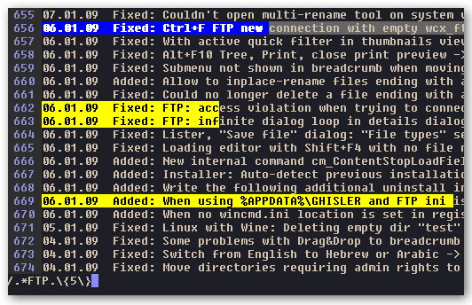

Not sure if it's exactly what you want but you could try vim.  It has views and somebody mentioned folding.  It may be useful and there are Windows ports of it for free.  May be worth a look anyway.

I have gVimPortable installed, and i fired it up, loaded a file, and then i'm lost. Do you have any specific directions?
/edit: found the following after looking through the help files that could help. Any idea on how it would work for say 'fold all lines that don't contain the string popup'
Code
*28.8*	Folding by expression
This is similar to folding by indent, but instead of using the indent of a
line a user function is called to compute the fold level of a line.  You can
use this for text where something in the text indicates which lines belong
together.  An example is an e-mail message where the quoted text is indicated
by a ">" before the line.  To fold these quotes use this: >
	:set foldmethod=expr
	:set foldexpr=strlen(substitute(substitute(getline(v:lnum),'\\s','',\"g\"),'[^>].*','',''))
You can try it out on this text:
Explanation for the 'foldexpr' used in the example (inside out):
   getline(v:lnum)			gets the current line
   substitute(...,'\\s','','g')		removes all white space from the line
   substitute(...,'[^>].*','','')	removes everything after leading '>'s
   strlen(...)				counts the length of the string, which
					is the number of '>'s found
Note that a backslash must be inserted before every space, double quote and
backslash for the ":set" command.  If this confuses you, do >
	:set foldexpr
to check the actual resulting value.  To correct a complicated expression, use
the command-line completion: >
	:set foldexpr=<Tab>
Where <Tab> is a real Tab.  Vim will fill in the previous value, which you can
then edit.
When the expression gets more complicated you should put it in a function and
set 'foldexpr' to call that function.
More about folding by expression in the reference manual: |fold-expr|

1) There is a "vimtutor". Use it wisely.
2) There is a help function, call it via :help <term>...
AFAICS Vim does not feature a built-in filter but it works with grep etc. (while I hope I'm just wrong as Vim features anything).
You could however use expression-based foldering which does not actually hide unwanted lines but folds them.
However, that would require basic understanding of Vim's regular expression syntax.

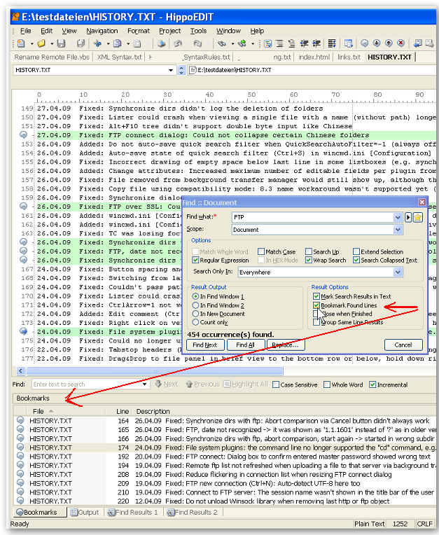

Basically in HippoEDIT you can "Highlight" and  "Bookmark"  all lines containing 'popup'
so you have an visual filter of---  and in "Bookmark Output" an clickable list of all matched lines.
With VIM i would just do an search and jump with 'n' and 'N' through the matched lines.

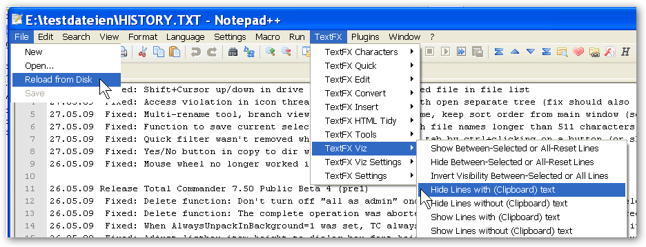

Or use Notepad++ with TextFX-Plugin:
Greetings, Stefan.
Cool! I did not know this! I use Notepad++ on a daily basis, now i know how to go about it.

Vim has couple scripts for search related filtering. Beside the scrips you can use gnu grep or Vim`s internal grep fro filtering lines in a new buffer. I generally use ":g -search text-" which is the easiest of all. Will show all the lines with the seach text.
