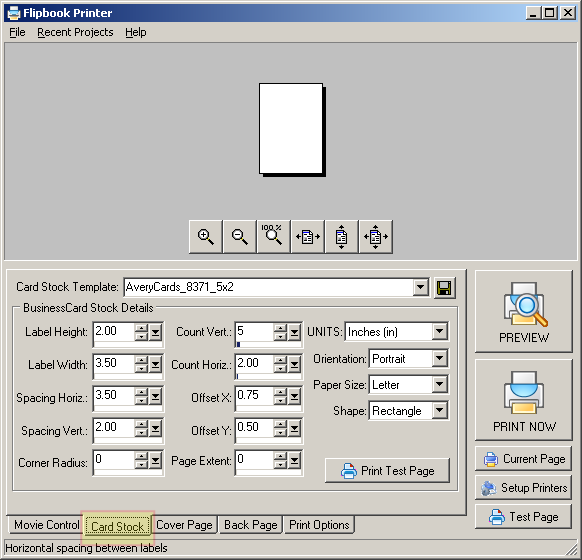

This is what I was talking about in my original post. Adjusting all that doesn't adjust the size of the paper being printed on in the program.
This is before switching to 'Custom' paper size. (Paper size is still set to 'Letter')
This is after. Note that the program has still not been told what size 'Custom' is.
HTH
Re: Using 'Custom' Cardstock or Paper size
« Reply #6 on: January 10, 2006, 06:48 PM »
looks like i need to add some way to specify custom paper size.  No worries, i don't mind adding support for this.
