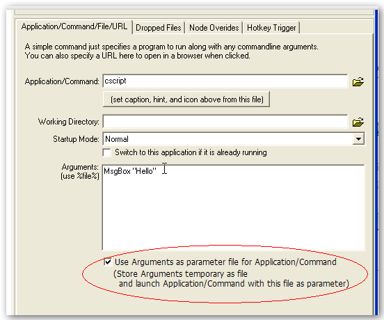

Maybe you can use the "Arguments:" box at "Application/Command/File/URL" Tab for this issue?
Just add an feature to save this Arguments as temporary file in %tmp%
and give this temp-file as parameter to the app defined in "Application/Command"-field.
After executing delete the file.
Greetings, Stefan.
AbteriX
  • Member #520
  • Posts: 1,150
Re: Hotkey commnads via icons
« Reply #11 on: November 20, 2009, 08:49 AM »
Or maybe better provide an %arg% parameter.
I think about using this %arg% in "Application/Command"-field.
If LBC find %Arg%, the content of the Arguments-field is saved as temp file with an extension given after %arg%
and the placeholder "%arg%.ext" is replaced by the name of this temp file
and the "Application/Command" is executed with this expanded command.
That way i could use
Application/Command: cScript %Arg%.Vbs //B //T:20
execute: cScript %tmp%\xfgskxnnkj.Vbs //B //T:20
or
Application/Command: AutoHotkey.exe [Switches] %Arg%.Ahk [Script Parameters]
execute: AutoHotkey.exe [Switches] %tmp%\iudshjbbf.Ahk [Script Parameters]
Greetings, Stefan.
