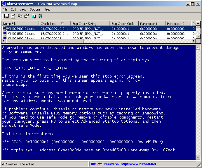

It that was the message [IRQ_LESS_OR_EQUAL...] it is more than likely a faulty driver.
If you want to track down past BSODs try http://www.nirsoft.net/utils/blue_screen_view.html which allows you to look at past BSODs and lists the drivers involved.
I have found this incredibly useful for troubleshooting.

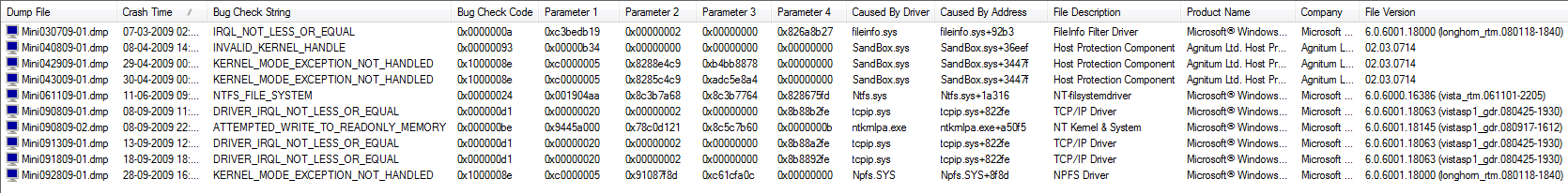

I thought it actually was a realtek sound card I have that I have never been happy with (I could remove the card & use onboard sound but dont like messing with (=opening) the machine).
but I'm not sure:
The problem file is:
C:\WINDOWS\system32\drivers\cmaudio.sys
version is  5.12.01.0646
It's not quite clear - various sites say it's a soundcard driver, e.g. here
cmedia is here:
http://www.cmedia.com.tw/drivers.html
[edit] added corrected :-[ the version number
[edit2] there doesnt appear to be a more recent version, I presume it's related to the Realtek soundcard, which hasnt had any updates since I installed the already old driver from cd that came with it (2 years ago now I think..)
[edit3] times like this I hate computers :( - it could be the first offer on the list in the cmedia page linked to above. I might do a backup(=image) and try it out...

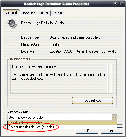

Why not just disable it in the Device Manager to test your theory? :)

I'm a little confused, Tomos. You say there are CMedia audio drivers installed on your system, but keep saying you have a Realtek soundcard. Those are two different companies & a Realtek soundcard isn't going to use CMedia drivers.
apologies for the confusion - the soundcard is TerraTec (I got it wrong earlier)
The onboard sound on the mobo is from Realtek
I tried what 40hz suggested & disabled the Terratec drivers and have yet to reboot
