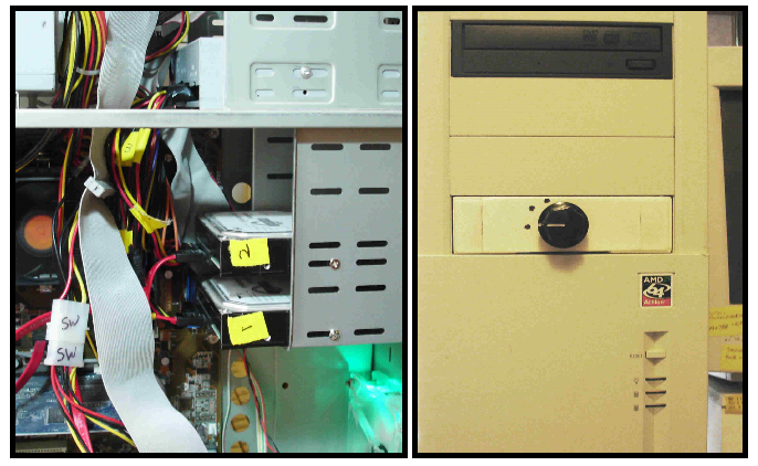

This is a very good idea mouser. You mentioned two alternatives: a separate computer or one computer with virtualization software. A third to consider is one computer with a physical SATA switch, like this one http://www.thesataswitch.com/ , to switch between two separate (sets of) harddrives. I have a switch like that but for PATA. Pic above website:
drawbacks:
- you can't flip between host/virtual OS, you must shut down and reboot
- requires tinkering/soldering
advantages:
+ less costly and space consuming than buying an extra computer
+ more complete separation between the two systems compared to virtualization software (First, the software might have bugs that allow things to break out of the guest OS into the host. Second, if malware makes it onto the host then it might be able to keylog, do screenshots etc in the guest OS window too. The risk for that is low I think, but why not remove it if it comes easy.)
+ requires tinkering/soldering ;D

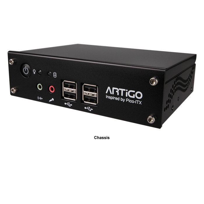

Another idea that could appeal to the geek in you :)
Install a VIA Artigo a1000 into a spare 5.25 bay and use a KVM to switch.
that is cool.
