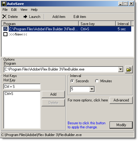

I tried running http://www.atopsoft.com/products/autosave/ and have it like so:
But it doesn't do anything at all.

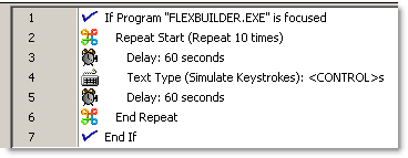

I tried unsuccessfully to write a macro in MacroExpress:

Your MacroExpress script won't do anything unless Flexbuilder.exe is focused.  You'd have to activate the window first, which would make the "If Program is focused" line true so the rest of the macro would run.  Having the Flexbuilder.exe window activated/focused would also be necessary for the <Control>s to work.
Try a series of:
  If Window X running
    Activate Window X
    Send Save commands to Window X
  End if
  If Window Y running
    Activate Window Y
    Send Save commands to Window Y
  End if
etc

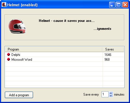

I haven't tried this myself...  from Jimmy the Fork:
Helmet
Clicks the save button on any program.
See the author's screenshot below.

Thanks rjbull.
But 'Helmet' doesn't have the option to specify save time interval to less than a minute.
fiddyschmitt
  • Posts: 17
Re: Looking for a AutoSave program
« Reply #12 on: September 27, 2009, 01:18 AM »
Thanks rjbull.
Hi sri, that's true. I only wrote it for a min of 1 minute. If you're looking for lower than that I think you may have an extremely unstable computer ;-)
