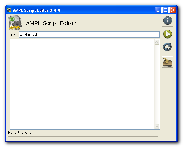

  • There is also a new "Simple Script Editor" window. If your script can be loaded into the Simple Window if there is no command and only one Step (ie Recorded Scripts)

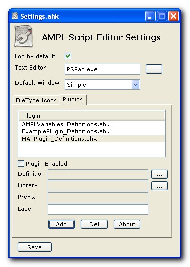

  • Improved the integration of Plugins with Script Editor: See the updated MAT Plugin

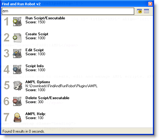

The default shortcut to initiate AMPL is am. Typing am in the FARR window will list the sub-commands:
Typing am <string> will list the scripts that match the <string> search. Selecting one will run the script.

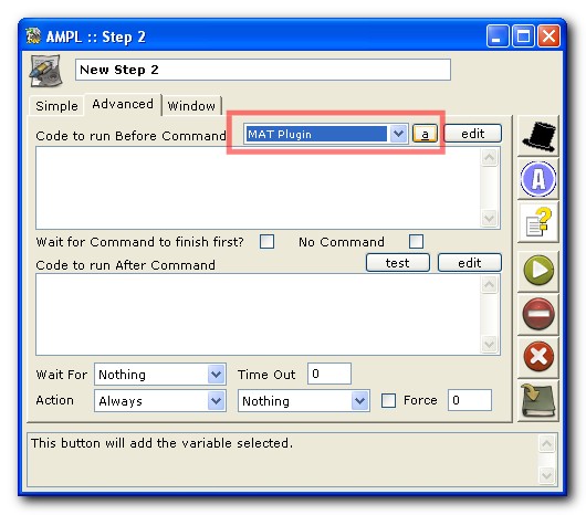

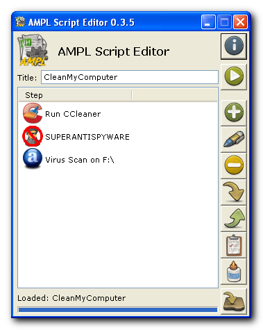

The Script Editor enables the creation of the Script's steps, each step can run a programme and/or AHK code. AMPL Script Editor comes in two flavours:
Normal
Simple

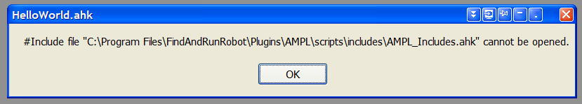

Re: FARR Plugin: AMPL [beta version 0.5.0]
« Reply #4 on: September 21, 2009, 11:12 PM »
Sorry, found what I needed in ...\FARR\Plugins\AMPL\Scripts\HelloWorld.ahk.
I was looking higher up the file tree.
[attachthumb]

Here's a trifle: (see attachment in previous post)Presumably, most who use this will have opted for default installations of Farr but...
I took a quick glance at the files before posting this but didn't immediately spot where I can modify the path.
The includes are in the AMPL folder but my copy of FARR isn't where AMPL thinks it is.
Good point: I should have said that if FARR isn't in C:\Program Files\ Then you'll need to edit and save the script first.

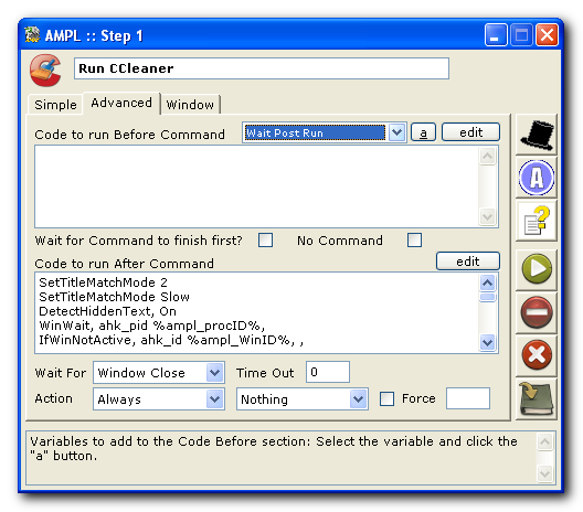

AMPL also can be extended with Plugins. Plugins can come in two parts:
1. A Definition file that is used by the ScriptEditor to insert code into the script, and
2. Optionally, an AHK Library Include file that will be called at run time.
There are three basic types/purposes of Plugins:
  • Gui's to insert code into the code Before and/or the code After sections. The AMPL Variables Plugin is an example
  • A wrapper for an external programme
  • An AHK Function Library & Definition combination.
I've just done an example of a Plugin Wrapper type that uses skwire's new MouseAccelToggler.exe coding snack.
But first some instructions on how to install a Plugin...

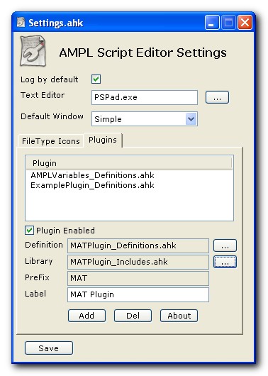

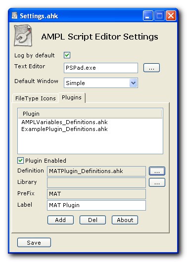

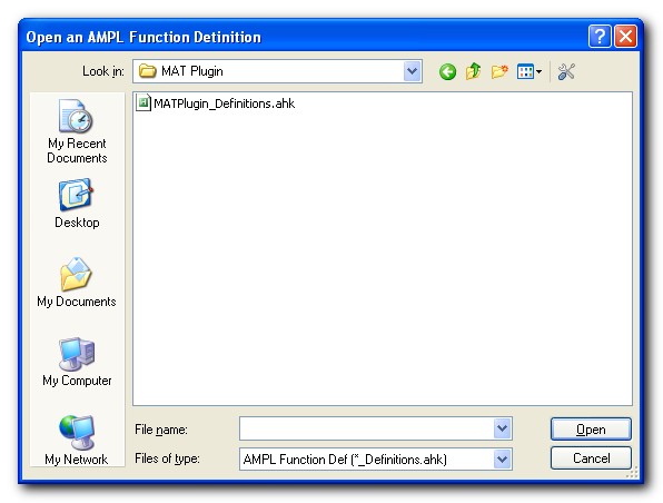

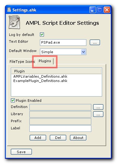

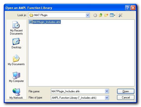

First of all, the Plugin has to be downloaded and saved to your filesystem somewhere. If there are executables included there may also be specific installation instructions for that aspect.
New Plugins can be installed from the Settings window.
The settings programme can be run from the ScriptEditor by Shift-Clicking on the About Icon:
1. Navigate to the Plugins Tab:
2. Select the definition file by clicking the load button [...]
3. Definition files are AutoHotKey scripts named *_Definitions.ahk
4. Select the correct file and click Open. The file will be loaded:
5. If the Plugin also includes an AHK Function Library, load the Library file in the same way. Library files are AHK scripts called *_Includes.ahk.
6. Add the Plugin to the list by clicking the Add button:
7. Click Save to save the new settings:
8. If you ran the settings programme from the ScriptEditor you will need to exit the ScriptEditor and run it again for the new settings to take effect.
9. The new Plugin can be accessed on the Advanced Tab of the ScriptEditor:
« Last Edit: October 01, 2009, 02:12 PM by Perry Mowbray »

Once you've installed the Plugin you can use it to create specific scripts. From my reading of the original post, the idea was to be able to change the mouse acceleration for different occasions on the fly.
This Plugin needs to know where the MouseAccelToggle programme is, so when you first run the ScriptEditor you'll be prompted to enter the location.
So in AMPL you'd create a script for each speed setting you need, and name it appropriately:
  • Go Real Fast: speed=20
  • Go Real Slow: speed=1
  • GoNewSpeed: speed set at run time
Then in FARR it's easy to "search" for your required speed setting:
