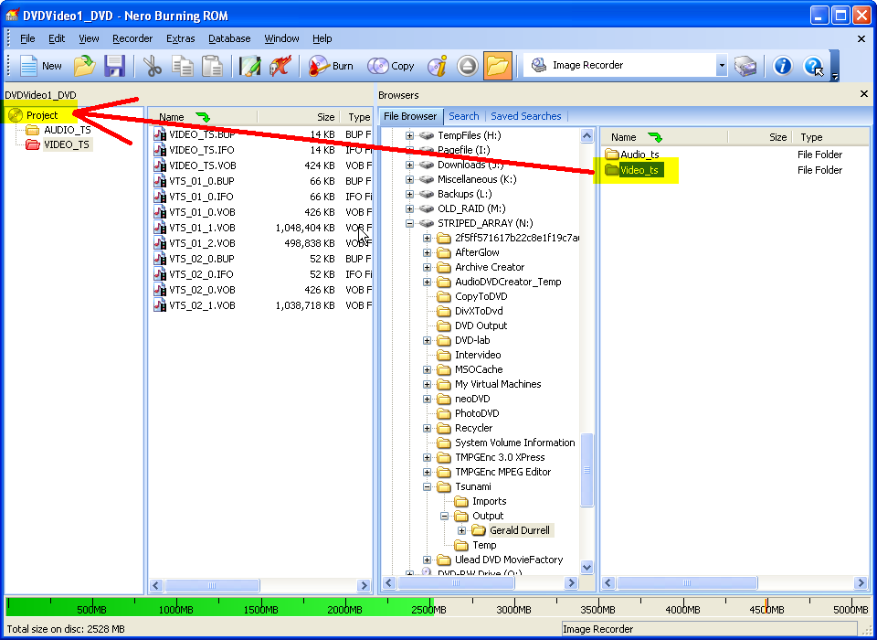

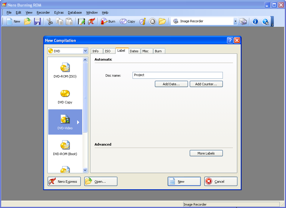

You need to load "Nero Burning Rom" from the start menu - forget using Nero Quick Start (the sort of task orientated interface).
You should get something like this:
Select DVD Video on the left and use the Label Tab to give the disc a short name:

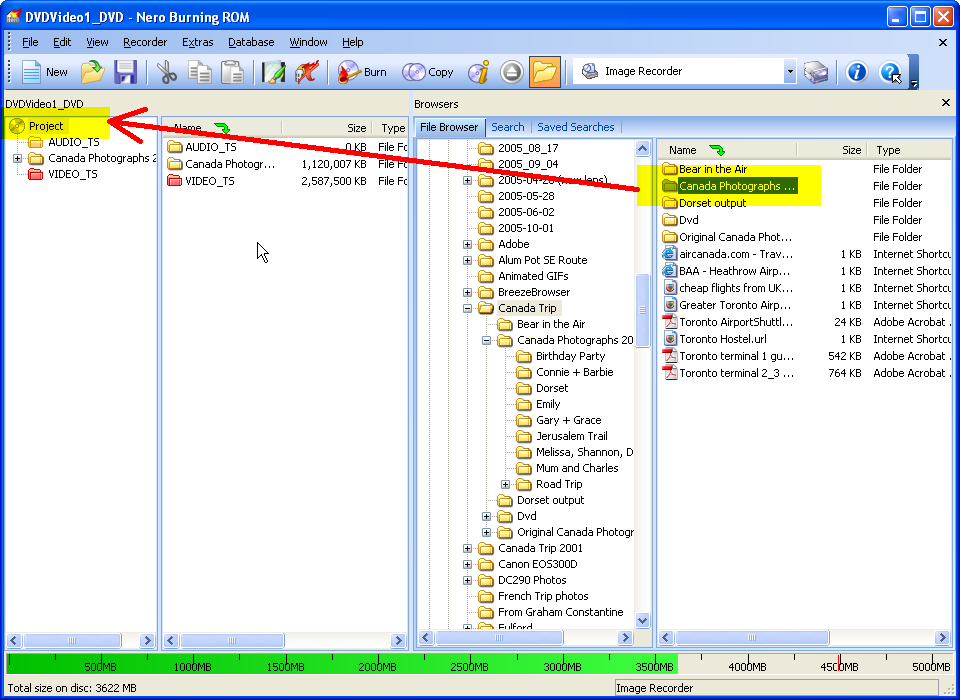

This brings up a template in which you can drag the VIDEO_TS to the root of this and it will add all your video files:
Now drag you folder of JPEGs to the root folder and it should create a folder with all the JPEGs in it:

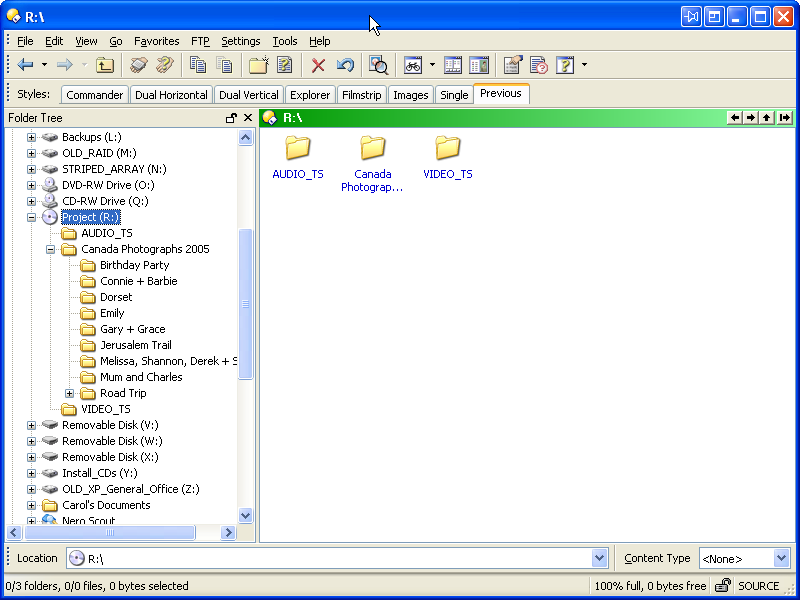

Now burn the project and you should have a DVD-VIDEO with a folder of photos on it too. Here is the file structure of the disc I burned by this method:
The DVD works fine (using Intervideo WinDVD7 on the computer, I haven't actually burned a physical disc, just an image which I mounted in Nero DriveImage), and the photos are all there (even in the folder hieracrchy) and can be viewed by 'Exploring' the DVD on the computer.
