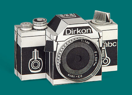

For a more 'Old School' version, try the Dirkon*.
Published in 1979 in the magazine ABC mladých techniků a přírodovědců [An ABC of Young Technicians and Natural Scientists].
Its creators, Martin Pilný, Mirek Kolář and Richard Vyškovský, came up with a functional pinhole camera made of stiff paper, designed for 35 mm film, which resembles a real camera. It may not be the most practical of devices, but it works!
I wonder if you could make one out of thin sheet metal to make it more durable?  :huh:
*The name Dirkon is a play on words based on the combination of the parts of two words: Dirk- is the beginning of the Czech word dírka – pinhole, and -kon is the end of the name of a well-known Japanese camera which needs no introduction.
It has that eastern block look! or is it just a 1979 look? - a combo of both probably ;D
