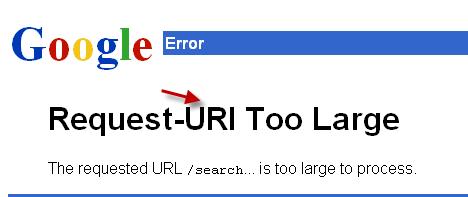

Yeah thats the way i wanted the Video to show up, if the whole idea is just to copy/paste the embeded code on another page, i did that n a Google error showed up (saying , the requested url was too large to process)
