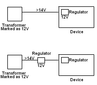

I'm going to have to cast my vote for gradual heat damage being the primary culprit.
Power surges to the actual router shouldn't be too much the issue since your devices all use "wall warts" for their power supply. Although these devices aren't surge suppressors or line voltage conditioners, they do provide a fair amount of protection to the devices they power. So unless they've been damaged, I'd look elsewhere.
If you check the output coming off your router's power supply with a multimeter you should be able to see if the correct voltage is being supplied. I'd be especially on the lookout for specs that read lower rather than higher. Low voltage can often cause a device to run hotter than it should.
The situation could also be brought on purely by environmental heat factors. Either the router is getting too warm by being where it is; or the power adapter is providing the wrong (likely low) voltage since many power devices will produce lower supply voltages when they overheat.
Suggestion: if you do test your adapter, try running it in its normal environment for an hour or two and then try to test it immediately after you disconnect it from the router. If there's a bad voltage condition, brought on by environmental or runtime factors, this will help you catch it.
So either way, I guess I'm going with heat damage as my answer. ;D
According to Linksys' site, the PSU for that router is switchmode so you won't be able to get an accurate reading unless it's under load - and it still won't tell you how much ripple is on the output which is a problem when the capacitors in a switchmode start going high-ESR due to, for example, heat strain and voltage fluctuations.
It would be easier to replace the PSU with a known working one.

Sean (one of my hardware tech buddies) pointed me towards this article, which discusses wall warts in detail, along with a project to safely add voltage regulation and filtering to an inexpensive plug-in power module.
That article is for your basic transformer style plugpack.  The circuit that is detailed is normally, (just to clarify - if the manufacturer wants a cleaner supply he may incorporate a simple switchmode design in the device itself but generally a lot of equipment uses basic linear regulators, eg. 7805, 7812, etc), what you find connected to the power input socket of the device - so in effect you are connecting another circuit that's the same in series.
The only problem with that is you've just disabled the internal voltage regulating circuit of the device.  The regulators mentioned in that article require at least an input voltage 1.2V above the required output voltage in order to regulate correctly otherwise they just drop out.
eg.  If your device requires 12V DC there will typically be a 7812 regulator connected to it's input power socket - it's relying on the normally unregulated voltage provided by the transformer plugpack of around 16V DC allowing it regulate correctly.
If you build the circuit as described and set its output to 12V DC and then plug that into your device, where does the internal regulator get its required voltage drop in order to regulate?
I would say he has success probably because of the extra filtering he's added by way of the capacitors.
Switchmode PSUs are self-regulating and don't require it, they only require the requisite load for regulation - and the latest versions don't even require that.
EDIT: Also note that article is from 2005, switchmode plugpacks have become more prevalent in the last 2-3 years.
Addendum: @raybeere: If the PSU is indeed a switchmode type, (they're generally lighter than transformer types is the easiest way to tell), then you should change it for the same type with an equivalent rating if you intend to.  The unregulated output from a generic transformer based PSU might damage the router, (unless the replacement specifically states it is regulated).

I did mainly only look at the circuit, (which is just the standard linear regulator circuit), but I also noted from the article they never took into account the fact that most transformer powered equipment will have it's own internal regulator which is the point I was making.
The top circuit shows the typical setup for a device powered by a transformer based plugpack - the regulator is situated within the device and while it gets the full voltage from the plugpack, it will happily perform it's job.  (A 12V unregulated transformer based plugpack can typically provide up to ~16V.)
The bottom circuit shows what you get when you follow the article, you have removed the internal regulators minimum voltage drop - it will no longer regulate.
Within the range of regulated supplies requiring 100 to 150 milliamperes or less, the primary concern in selecting a wall wart is to make sure that it will supply power at least 3 volts DC in excess of the desired final controlled voltage, when the circuit is running at the designed load. This "3 volts in excess" comes from the basic needs of the voltage regulator itself. The most straight-forward approach to selecting a wall wart for your project would be to select one with an amperage rating that matches your needs and a voltage rating that is 3 or 4 volts higher. Thus, if you need a 5 VDC, 100 ma. regulated supply, you might select a used "9 VDC" wall wart rated at 100 or 150 ma. If you need a 9 volt regulated supply at 70 ma., you might select a small "12 VDC" wall wart rated at 100 ma.
The selection becomes a bit more complex, if you desire a 12 volt regulated supply. One way to go is, as discussed above, to use a 14, 15 or 16 VDC wall wart rated at least as large as your design load in milliamperes...
All they are concerned with here is the input requirements of the external regulator they are adding, not the input requirements of the internal regulator of the device.  ie. The internal regulator could be relying on that 'excess' voltage from a transformer.
It all comes down to the construction of the device that's being powered.  Personally, I wish they'd get rid off the freakin' need for the plugpacks - I'll generally try to buy equipment that doesn't require them now, direct mains powered is so much easier.
