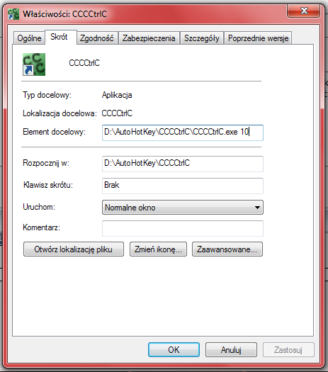

This sounds very weird, probably you are doing something wrong. Please have a look at this screenshot (although it is in Polish).
pulsi
  • Posts: 3
Re: CCCCtrlC - simple multiple clipboard utility
« Reply #31 on: June 27, 2010, 08:06 PM »
Looks exactly as I described (except the language), when I add a 10, 50 or whatever after a space it comes with an error message.
Greetings from Germany
Stephan Puls
« Reply #32 on: June 28, 2010, 05:25 AM »
does your path have a space in them? if so you have enclose the path in quotes, like this:
"C:\Program Files\CCCCtrlC\CCCCtrlC.exe" 50
