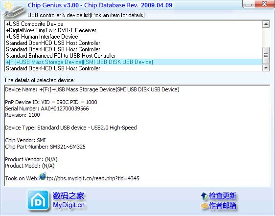

For a more detailed look at your USB Flash devices you can also check out ChipGenius, (Google translated).
ChipGenius (chip Wizard) is a USB device detection tool-chip models, it will automatically query disk, MP3/MP4, card readers, mobile hard drive and all USB devices chip control models, manufacturers, brands, and provide relevant information Download Address.  Of course, can also access the USB device VID / PID information, device name, interface speed, serial number, equipment and other versions.
Small green software, plug-and-play, digital consumer electronics enthusiast, DIY and maintenance personnel digital good helper around.
After analysing a drive it can also provide a link to a production tool suitable for that drive that can allow you to change various parameters of the drive, eg. you can turn it into a virtual writable CD drive - or render it useless if you screw up.
