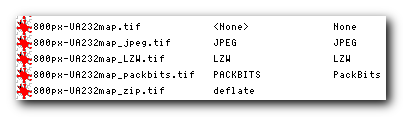

The first plugin recognises the LZW, jpeg, Packbits and zip/deflate formats.  The second one recognises the LZW, jpeg, and Packbits formats.
@tomos: maybe you can try this LibTIFF tool - tiffinfo.
tiffinfo works as well and recognises the four formats listed above.

I'm not sure which plugin I got the custom column from - it's called 'compr' - but it's working  (LZW) and seems dependable so thanks for the help people :Thmbsup:

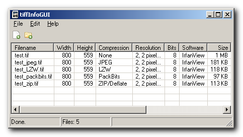

« Reply #17 on: June 25, 2009, 09:29 AM »
maybe an AHK front-end for tiffinfo would come in handy for non-TC users. :)
I could easily code this up...however, is there enough interest?  Speak now!
Re: tool to check if TIFF files compressed ?
« Reply #18 on: June 25, 2009, 11:16 AM »
i wouldn't mind having a GUI for the tiffinfo program. who knows, it might come in handy one day.
    • Superboy Coder
« Reply #19 on: June 25, 2009, 05:23 PM »
Here you go:  tiffInfoGUI download
« Last Edit: August 07, 2009, 02:33 PM by skwire »

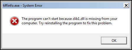

btw, this error appears when opening tiff files. just fyi.
Edit: the above error has been fixed, thanks Skwire. :-*
« Last Edit: June 26, 2009, 06:04 AM by lanux128 »
« Reply #21 on: June 26, 2009, 06:17 AM »
Fixed.  Added:
  • Size column.
  • Total files in statusbar.
  • Double-click launches the tiff file in your default viewer.
Thanks, lanux, for the feedback and suggestions.
« Last Edit: August 07, 2009, 02:32 PM by skwire »

works well - thanks Skwire :Thmbsup: I just used it to double check (used the TC plugin too) all agreed so I happy :)
