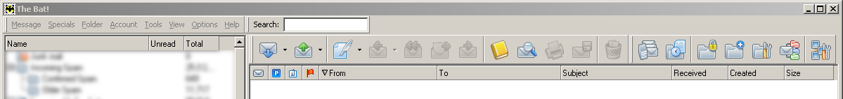

I took a look at the Bats' forum today and tried to post a new thread but couldn't find the post new thread button (surfing in Firefox).  So here we are!
How does someone make the menu icons smaller?  Right-clicking on the menu gives you the Customize option which then offers you an infinite list and i can't see this option anywhere!    :o

« Reply #1 on: December 22, 2005, 03:55 PM »
i remember you can do it, but i can't remember how.. there is a newsgroup for thebat, i'll check it in a bit.
may i make a recommendation though.
i also tend to always look for small icons.  however, after using the bat for a couple of years, i've concluded that because you are going to be pushing these constantly, it really does help to have big buttons.  you might want to try it for a couple weeks and see if you don't get used to it.. that's my recommendation.

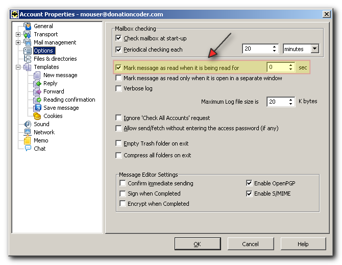

Is there somewhere to customize how long you have to be on a message before its status changes from unread to read?  Usually, email programs have a way to change how long you actually have to read a message before it becomes read.  I want to shorten the time it takes to almost 0, but I can't find the option for it anywhere.
Re: The Bat - how to customize?
« Reply #5 on: January 23, 2006, 07:29 AM »
absolutely there is - in fact the first thing i do with each new account is set that to 0!
it's in the account properties:
« Reply #6 on: January 23, 2006, 04:28 PM »
Ah!  Thanks, mouser, we think alike yet again. (I still can't believe that you like realplayer  ;) )
