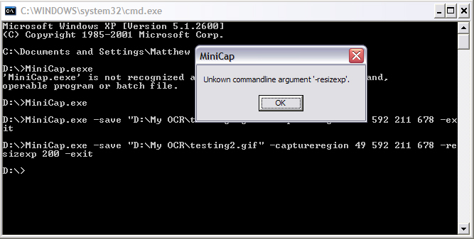

the -resizexp or -resizex command. I can take a screenshot - see attached.

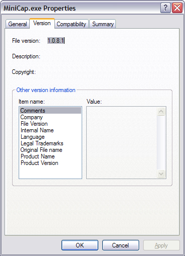

So, I deleted my entire MiniCap directory just to make sure I was getting the correct version rolling. I downloaded your version you just posted and haven't tried the script yet. The reason is, I wanted to show you this via its properties in windows (see attached). I don't know if this is correct, or if its signalling a problem, but this is what I was quickly mentioning before. This quite clearly isn't labeled the correct version, even if the setup.exe said it was installing the correct version - which it still might have, but the label might not be updated.
Re: Minicap Download, Version & -resize
« Reply #5 on: June 15, 2009, 09:41 AM »
the properties version is meaningless in my apps -- i should keep it updated but i rarely do.

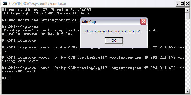

Ok - now I did it manually via the command line and the -resize (et al.) commands, still don't work. So obviously im (1) either running the wrong version.. which seems highly unlikely since I installed from your direct link numerous times or (2) something is messed  :(
See Attached (tried with and without resize)

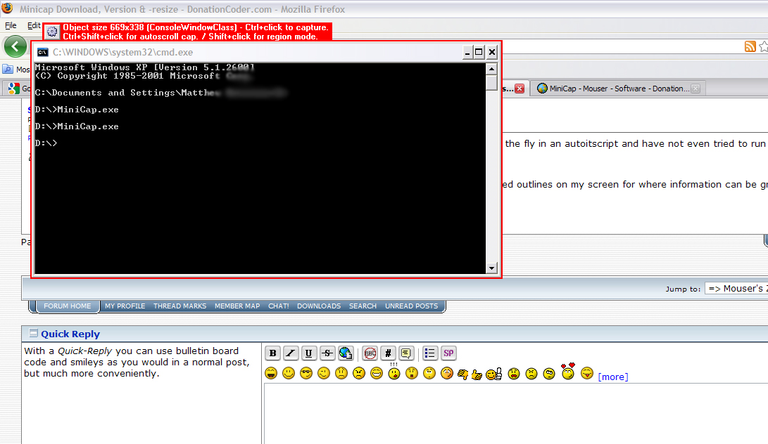

When I run minicap.exe I don't get a pop up with a title, I just get red outlines on my screen for where information can be grabbed. Should I be directing my eye somewhere else for the version label?
« Last Edit: June 15, 2009, 10:35 AM by S0789300 »
« Reply #12 on: June 15, 2009, 10:46 AM »
sorry my bad -- just hit escape (or capture an image) after the red box stuff, and you will *then* go to the main window.

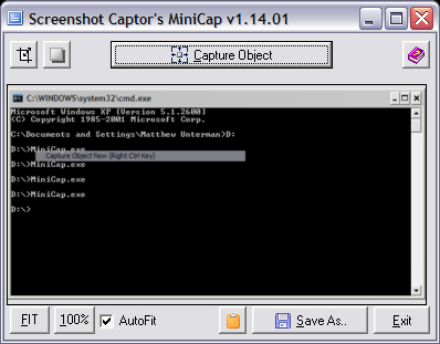

« Reply #13 on: June 15, 2009, 11:29 AM »
Ok (see attached).
Don't know why its this version, as I installed from your link! (And deleted the old one and tried again!)
Were the commands implemented in this version? Where to go from here?
Thanks for all the help thus far
« Reply #14 on: June 15, 2009, 11:35 AM »
well the cause of your problem is clear, as suspected: you have a rogue older copy of minicap.exe installed somewhere on your path.
