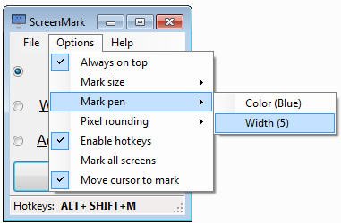

Hello again! In the process of creating the graphical interface for ScreenMark now :)
Currently adding mark on:
- Screen center.
- Working area center.
- Active window center.
With the options:
- Display mark on all screens (for multi-monitor setups).
- Enable Hotkeys on ALT + SHIFT + M.
- Rounding by floor or ceiling.
- Move cursor to latest mark.
This can do the job for first version.
More features can surely be added if you (or any other fellow user) require it later.
Feel free to comment if you want different hotkeys, et cetera... First version is the most-malleable stage
Cheers!

With the options:
Proggie's progressing:
Options have expanded:
First version's shaping as a goodie/keeper, functionality-wise  :)

ScreenMark v0.1.0 released
It should be good enough for your use-case: Launch program, put target on foreground, press CTLR+ALT+M to mark.
This is traditional Winapi/GDI+ painting (so the mark is "sticky" until stopped).
We can try other ways to mark such as full-screen invisible click-though form Window & hooks if you wish :up:
I'm open to adding improvements with further versions :) i.e. Move cursor to mark / more control on mark features-/ other.
Cheers!
