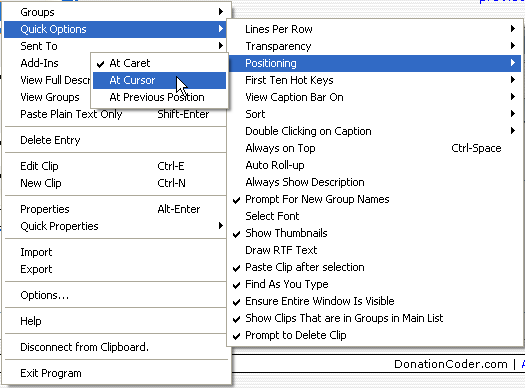

Screenshot from Ditto:

Yeah, I'd forgotten exactly which features went with which of the many clipboard apps I've tried recently. It's ClipMate, I think, which can't open its window at the cursor or caret.
Nevertheless, the Ditto window is still just a window, rather than a menu. The selection doesn't move as you move the cursor, and you have to double-click to paste, rather than just single-click. And you have to (scroll and) click into 'favorite' groups, rather than mouse-navigating through CHS's cascading menus. (Or use the keyboard, of course). I could certainly live with it, if I had to, but I prefer the CHS system.
I also use CHS's formatting presets to clean up line breaks, etc. And sometimes the spellchecker.
So I really, really hope Mouser can find the problem.
