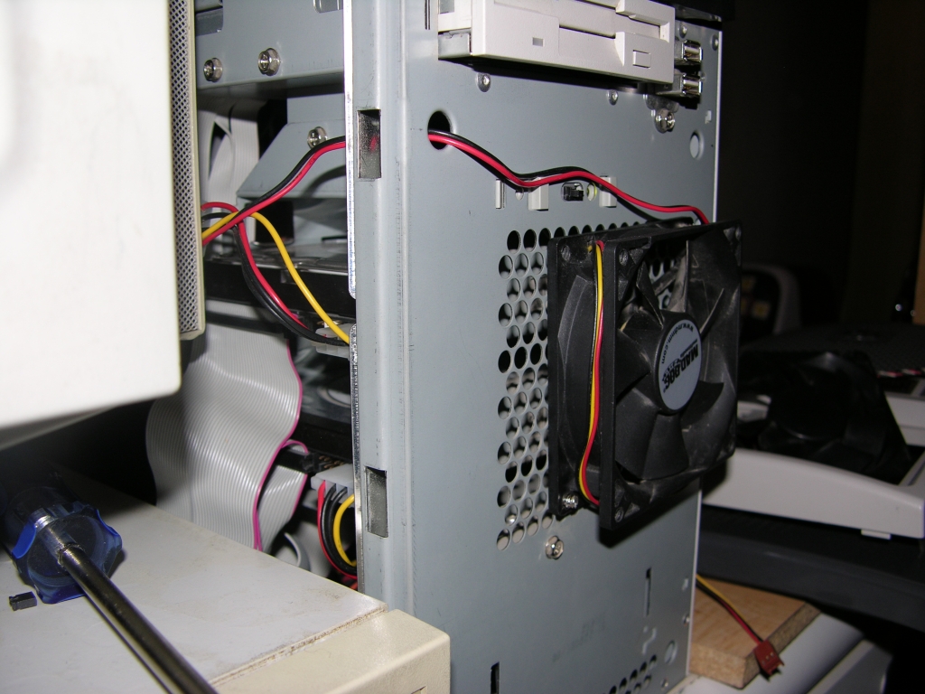

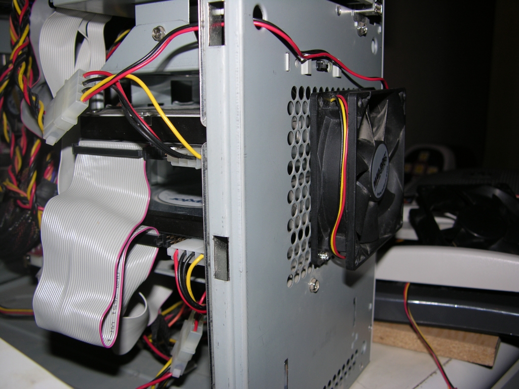

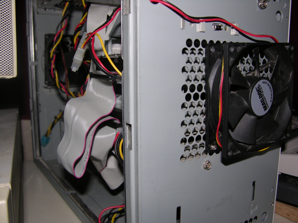

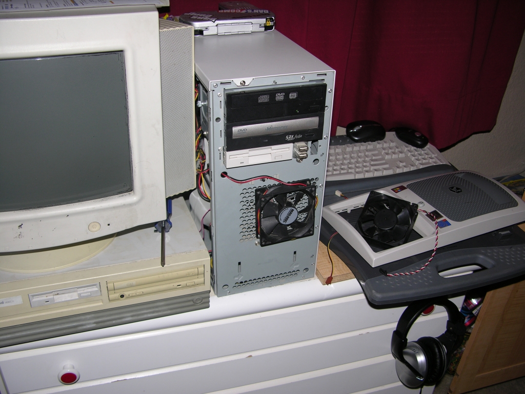

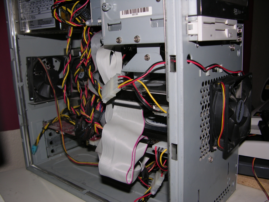

Computer as-is normally (faceplate removed):
Up close (both drives visible):
Up close 2 (both visible):
Up close (length of case visible):
Full case:
BTW: The IDE ribbons are *not* in the way of airflow, as the images lead to believe. The computer is also ON (and that fan is spinning) in the pictures, too (camera captured it otherwise).
Based on those pictures, any suggestions what I could do to get more air flowing? My temporary solution won't last long (sister/friend comes over, "What's this? OW MY FINGER" is imminent... :-\)

Having the sides off the case actually decreases airflow.
probably wouldn't make that much difference in this setup
personally I'd cut an opening in the case behind the fan, mask the openings in the case either side of the fan, and mount the fan so it's drawing rather than blowing...

As Deo said, cut the case away behind the fan, 50% of the air flow is being blocked - however, I'd still have it set to blow over the HDDs since you know where the air is going and you are using cooler outside air to do the cooling.

EDIT: You should also cut out the pressed metal grill that the rear fan uses as it's wasting it's time sitting there spinning with that amount of metal in front of it.  If you must have a grill, (to save the cat's tail), then use a wire grill like you used to find on decent PSU's, like this one.
