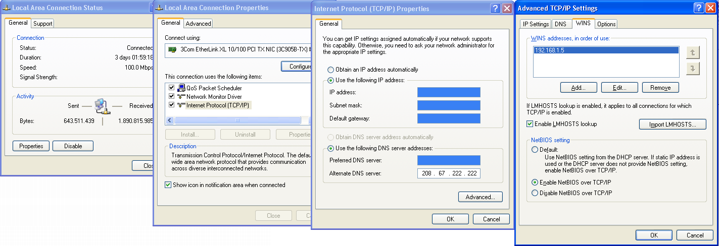

Updating of the list goes a lot faster when you also enable a WINS server somewhere in your network. Current routers do not require the use of WINS since it is old, but if you do use one, networking does seem to work smoother using XP and below. How Vista and Win7 handle networking is unknown to me, I only know that the software for networking has been adjusted and that in those cases the use of the wizards is preferred.

So the basics work, but Windows itself is the problem. By using WINS in my mixed (Windows/Linux) network the updating of available PC's (and their name) in the network goes a lot more smoothly...but still not perfect.
Now I know that the 'Computer Browser' service is responsible for getting and updating this list. Here is a link that provides a lot more info about this service and how to troubleshoot it. Likely you will have to download a Resource kit from Microsoft, but those are free as far as I know.

To be more clear, I used Webmin to control all services on my Linux PC including Samba, which gives you an option to enable WINS. Having said this, I just learned that there are subtle differences between the WINS from Samba and the WINS  functionality from a Windows server.
With server I mean a server edition of the Windows Operating Systems (Windows 2000 and up). More specific info about how to enable WINS on a Windows server can be found by following this link (MS TechNet). After having done this, you still have to configure WINS on the PC that will act as a client. This you can do in the advanced network configuration settings.

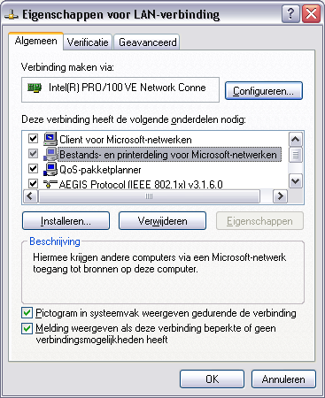

Besides that, you should make sure if the following network protocol is installed/activated on the network card that you use to connect to your network: Sharing of files and printers on a Microsoft network (roughly translated from Dutch).
