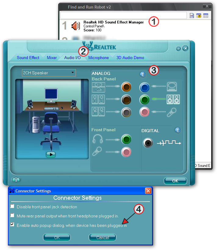

you didn't say anything about your OS or your audio drivers but i usually have this problem with Realtek. my workaround is to enable the "Enable auto pop-up dialog when device has been plugged in" option within Realtek's Sound Effect Manager, see screenshot for more details. so when your PC comes back from standby, you can just click 'OK' on the message box that pops-up and your sound should work.
Realtek was what I had problems with on my HP. It was misdetecting whether I had a set of earphones plugged in or not and switching modes on me. Enabling that autopopup made it happen more frequently, so I had to disable that.
I'd have to force it to correct itself by actually plugging something in and then unplugging it, forcing it to switch to the correct mode. Funny thing is that was usually the only time I ever plugged in a set of earphones. I didn't have any other use for them except as a Realtek fixing tool.
