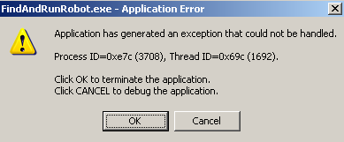

I know this has nothing to do with the plugins themselves because they were working fine. I just restarted and Farr does not want to work as long as I have the calendar and the alttab plugins are installed. I guess something is corrupted in the  windows installation that it is creating this mess here. I tried reinstalling microsoft c++ distributions but that did not resolve anything for me. Is there anything else I can do to make Farr working again with these plugins? These are the 2 I was using mainly really as far as plugin use goes.

Same thing, Farr crashes. I am %100 sure that some of the libraries used by those plugins might be corrupted because I have couple other programs that crash. The situation isolated to couple others but it is hard for me to figure out. Can you tell me which libraries you might have used under Windows? I wonder if it is possible to debug Farr and these plugins?
The thing is that Farr crashes when I try to invoke it not when I run it first time. So probably that is when Farr checks for existence of plugins then boom it crashes without much error detail.  Here is the useless error message.
