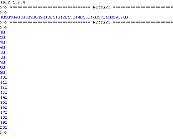

ok this is getting weird. Here is a screenshot from idle running with ',' and without it. First one is with a comma, second(vertical) is without
« Last Edit: April 15, 2009, 09:09 PM by kartal »

You're going to need to use a console that at least supports control codes kartal. I did ask if you were using the Windows console to which you did not respond.

Hm, your IDE probably doesn't handle the \r character properly - try running it from a cmd.exe console instead...

The "capture console output" window in IDEs lack a lot of stuff that a "real" console has. Unprofessional that \r isn't handled correctly, though :)

Yes. Your problems are because you are using an interactive IDLE session. You need to run it from a console. Personally, I never use IDLE.
