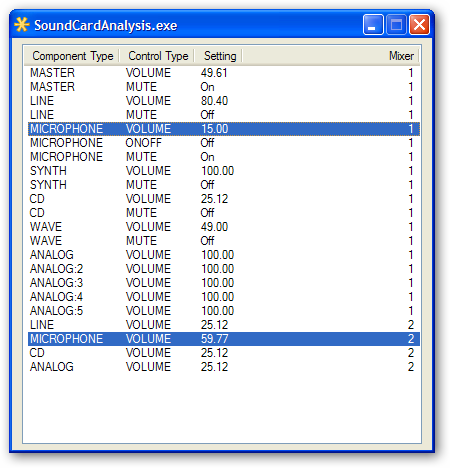

then we need to find out your sound hardware setup.. pls run this 'Sound Card Analysis' file and post the resulting window (see sample pic).

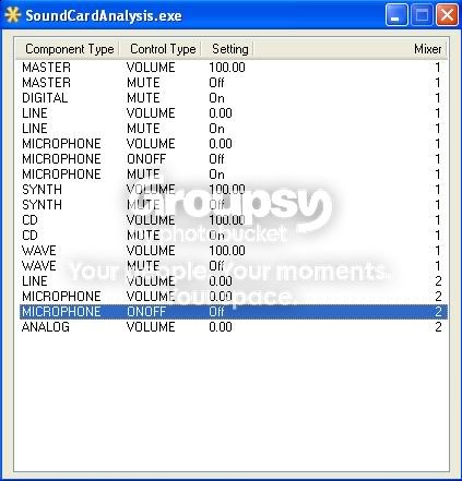

here you go
Re: IDEA: Microphone enabler
« Reply #16 on: April 03, 2009, 02:01 AM »
from the screenshot it shows the mic as the 2nd component unless you have two microphones in the playback panel. anyway, try both of these scripts and post the message boxes' contents. also it might help to know what kind sound card do you have.. :)

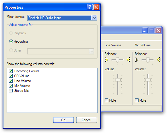

just to compare notes, i happen to have the same soundcard but i don't have a built-in microphone. as can be seen from the pic, i have the mute option. maybe i'll see if i can borrow a mic and do some further testing.
