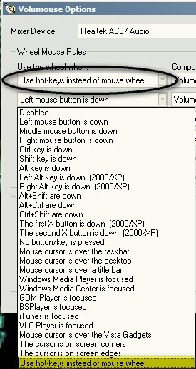

PhilB66
  • Posts: 1,522
@Coeluh
Why is Volumouse not working for you? It does exactly what you have asked for.

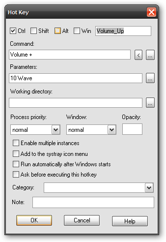

yksyks
  • Posts: 476
May I humbly suggest HotkeyP again? It works like a charm. Thanks for the idea, I just implemented it. I'm also using Shift-Volume buttons for attenuation when a phone call arrives, for example.
How did you add the volume button as a input thingy? When I press it, it won't show up.
yksyks
  • Posts: 476
Be sure to have the cursor in the top box and press the key. If it's not recognized then something might interfere. Do you use any keyboard utility? I have a Genius keyboard and I uninstalled the supplied key-mapping utility immediately and replaced it with HotkeyP.
Here's what I use:
PhilB66
  • Posts: 1,522
@Coeluh
Omg. I want to use my VOLUME BUTTONS ON MY KEYBOARD. not the scrollwheel on my mouse.
I guess you never really bothered to explore Volumouse, now did you? Again, you could USE HOTKEYS INSTEAD OF THE MOUSE WHEEL with it.

[Off - topic] I thought I would never have to ask but... is there an "ignore this person" forum feature and how do I activate it? [/Off - topic]
I'm terribly sorry. I even did open that menu, but I just was looking too fast. I'm stupid, yeah.
But I can't put in the volume button.It does not recognise it.
Here's what I use: (see attachment in previous post)
I've a Logitech Media Keyboard, used with Setpoint
