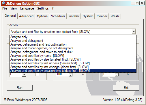

But there are options to choose.
You can put your directories at the beginning or end of the drive.
Ascending or descending.
Or you can leave the directories where they are.
does it recommend any of those?
JKDefrag offers
which is based on files rather than directories but I never could see the logic of it - especially to end of disk - unless you want to get them out of the way...

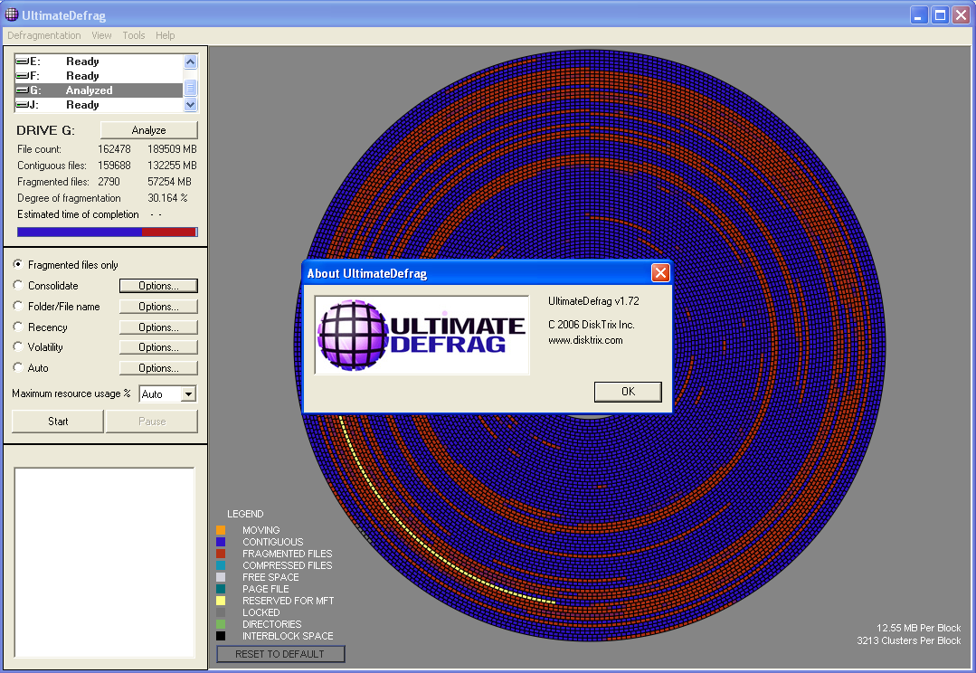

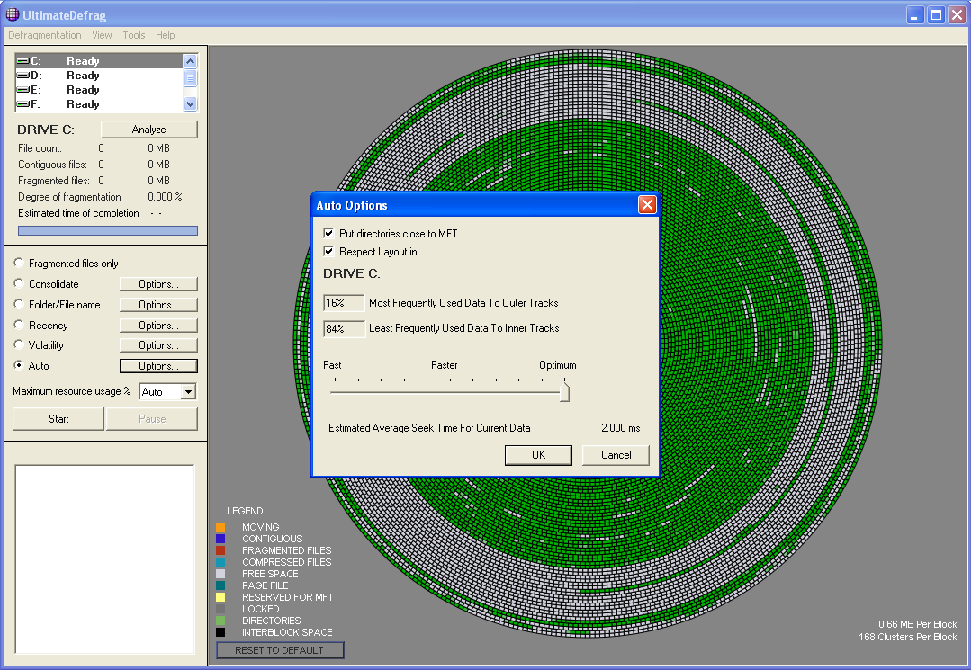

For defragging my hard disk I use (on a monthly basis) the 'Ultimate Defrag' software from a company called: Disktrix.
Guess some year ago they did a promotional campaign on the net to promote their new version by putting the previous version in the public domain. Previously I used Diskeeper but I was not satisfied with the results from that one, so I tried. And I am happy I did!
First, it doesn't require that stupid rule of 15% free space, it moves most recent data to the outer (faster) tracks, older data to the center tracks and puts folders next to the MFT (Master File Table). Because of all that, my PC felt as 'snappy' as a new installation again. Something DisKeeper was never able to manage. Until now everyone who has seen that software in action and worked with the result is grateful for leading them to a very good defragger.  It even comes with a manual that explains every option in clear, understandable English (PDF).
« Last Edit: April 05, 2009, 03:39 AM by Shades »

Ultimat Defrag looks very nice and seems to give a lot of control. However there are a couple of thoughts/questions I have:
How does it actually perform the defrag? Perfect Disk and DiskKeeper both us the MS API and if UD uses the MS API to achieve this (and hopefully it does for the sake of security and consistency) then how can they argue where they place files since the API only gives a virtual view of the hardware and doesn't let software where to physically place specific files on the hardware. A number of years ago I had a long conversation with a tech from Perfect Disk where I had it explained that actual physical placement is not possible through the API only logical placement within the API view. Logically contiguous files are really pysically contiguous but the software cannot guarantee which physical blocks on the hardware are used.

First of all I'm sorry for venting, but...
[rant]
I used to pay for DisKeeper (until version 8 or so), my main frustration with that one was that I have to have 15% of harddisk space free before defragmentation could took place.
Given the harddisk sizes of today that is a sizable chunk of space (for example: 30GByte on a 200 GByte disk/partition!!!!). The stupidity of that rule baffles me to no end. I have been around PC's long enough to know why that rule was put into place, but today that rule is insane.
With today's 1Tbyte drives i am not allowed to use 150GByte, because my defragger won't allow for it?!?
Denying me a 'snappy' system just because I use the total capacity of my hard disk?!??!
Do you have (an) contiguous file(s) of 150GByte in size on your disk? The biggest single file I have seen was 35Gbyte (Oracle database file).
Because the file size of the biggest (fragmented) file on a harddisk and equivalent free space on a harddisk should be the only reason why defrag software isn't able to start. And even that should actually not be a reason to start defragmenting the files that do fit in the available free space.
In that sense most defragmenting software has a lot of growing up to do.
Not the software from DiskTrix though. The harddisk in my system is an IDE WD Caviar with a capacity of 160GByte capacity (unformatted, 149GByte formatted). Directory Opus reports that this disk has 2,3Gbyte of free space or 1.5% free.
DiskTrix starts without any problem.
If Perfect Disk would commence to defragment my disk all the power to it, but my guess is that it either will not commence or will be painfully slow because of all the (literally) grinding work. DiskTrix commences without problems and it will take quite some time because of the amount of files, but it goes on without complaining.
Furthermore, how often is defragmenting required? DisKeeper was setup to run every night when I was asleep and still the results were not that great. Defragging every night puts (quite) some wear and tear on the disk. Nowadays I have scheduled the defrag software to run once a month.
[/rant]
It is just the stupid archaic rules required by this kind of software and the lack of results that drives me insane  >:(...and which make me a (very) happy Disktrix user.  :)

@f0dder:
The placement of files you can regulate in some sense. However, you also can use the layout.ini as is generated by Windows itself, so starting programs and booting goes fast.
I agree that 400%/500% speed gain is over the top, especially in the way you just posted  :)
However, their help file shows a calculation that makes some sense.
From the example:
A typical EIDE hard drive from 160GByte has the following specs:
  - Read Seek Time:        8,9msec
  - Latency:                   4,2msec
  - Full stroke seek:       21,0msec  (from center till the rim of the platter)
  - Track-to-track seek:   2,0msec
  - Transfer rate (max): 750Mbit/sec
The average Access Time for this hard drive is 8,9 + 4,2 = 13,1msec
The minimum Access Time for this hard drive is 2,0 + 4,2 = 6,2msec
The maximum Access Time for this hard drive is 8,9 + 4,2 = 25,2msec
Between the slowest and the fastest access time there is some 400% performance difference.
They also go by the following rule: 80% of the time you use only 20% of the files.
Those 20% of files are stored on the outer edge of the platter as the data transfer rate there is more like the promised 750MBit/sec, while the other 80% of files are stored near the center where the data transfer is more like 400MBit/sec.
Maybe I am just plain silly (or naive) but the idea of data and software I use most, stored in the most speedy area of the hard drive, does sound plausible to me.
For me the DiskTrix software led to a system that feels as 'snappy' as a fresh Windows installation for the best price as well, free.
For all intends and purposes I should send the help file, it expands a lot more about the reasoning behind their software and all of the possible options. Then again, I don't want to be regarded as a spammer  :D
