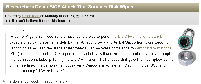

Uh... oh...
Via slashdot:
I guess the attack would have to be BIOS-specific (for finding a spot to put the malware) and slightly chipset-specific (for flashing the code to BIOS flashrom), but it's nasty nevertheless... combine this with SMM exploit and a hypervisor, and you're unremovable (except of course on motherboards where the flashrom chip can be removed from the motherboard - most seem to be directly soldered on, though).
Undetectable is still hard, even with a hypervisor, and I doubt it can be fully done. But you can go very stealthy.
