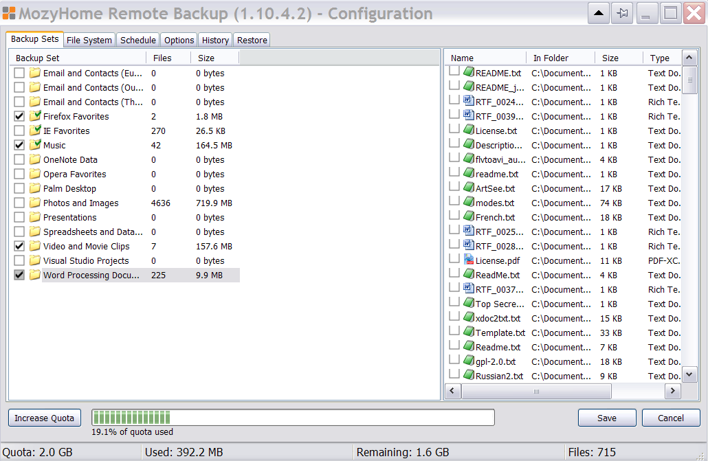

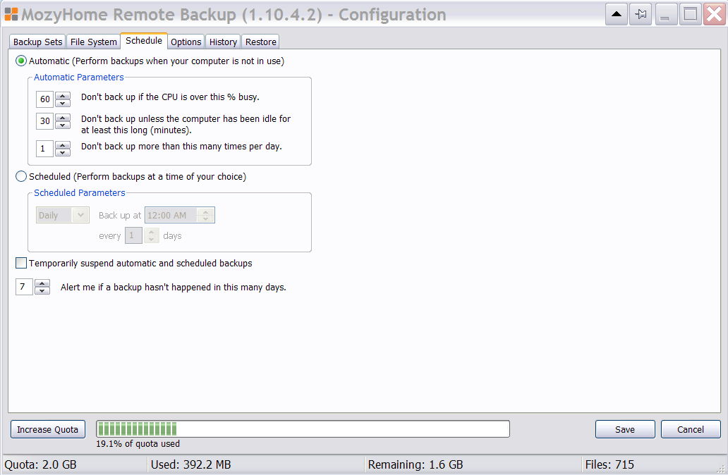

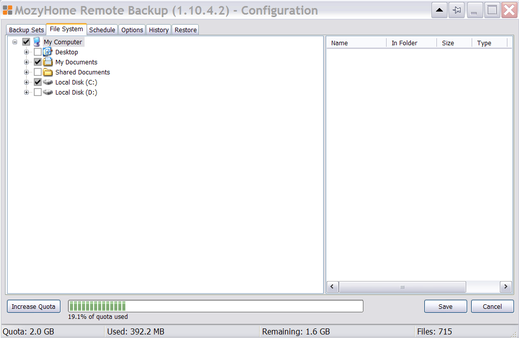

cmpm
  • Posts: 2,026
yeah - let me get a couple of shots
i have syncplicity, dropbox and mozy all on the same comp.
They don't conflict.

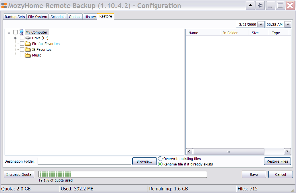

cmpm
  • Posts: 2,026
notice in shot 4 it can rename file if it already exists when restoring
in the first shot you can choose the file extensions or type to backup
hope this helps, ask more if you want to
