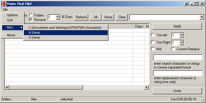

Be nice if the 'Add' button could remember the last directory.

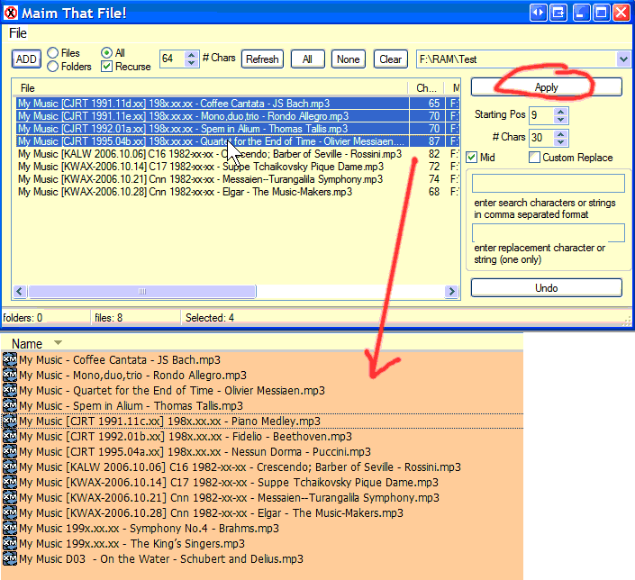

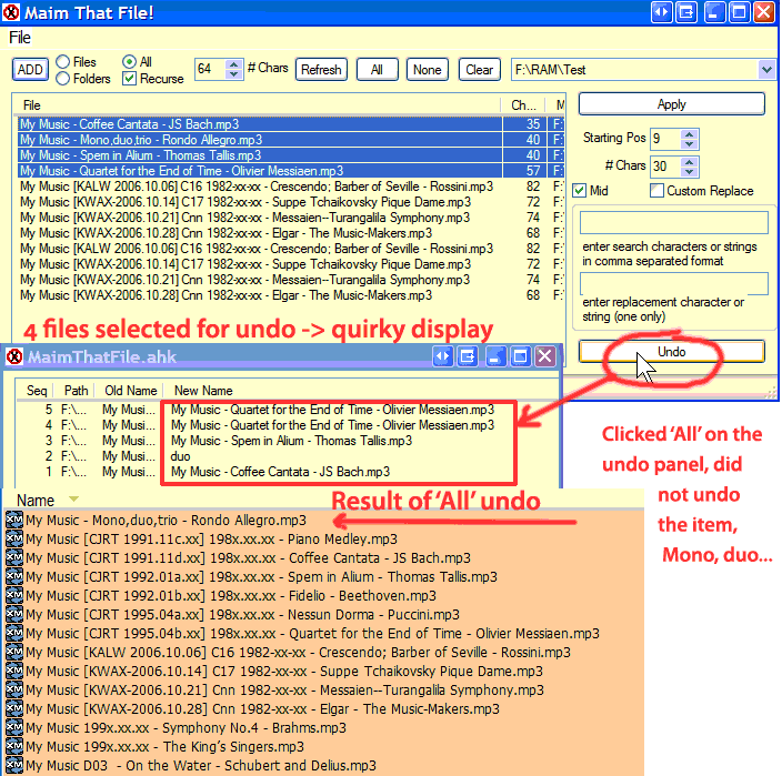

Okay, here's my situation.
It's all in here
I load a test folder with a few files by using the add button
(keep an eye on the file "Mono,duo,trio").
I highlight four that I want to fix, setting parameters in 'Mid' boxes,
hit 'Apply' and they're nicely renamed.
Oops, I change my mind... undo.
I don't understand the file-name display in the undo panel.
Follow the rules for stupid users and hit 'All'.
Okay... but what about the slippery "Mono,duo,trio" item?

I'll have a play with the undo functionality to see if I can duplicate your issue - you should be able to select an item (or items) and undo, or if you 'select all' it should, well, undo all...  Note that when you undo it should reload the list so the sort will change...
Having just written this it occurs to me that this may have something to do with the delimiters used in storing the list - I've been playing with them in the main window and can't remember if I extended those changes to the undo list...
I've changed the ADD button to default to the last loaded folder (seems to work but not tested rigorously)

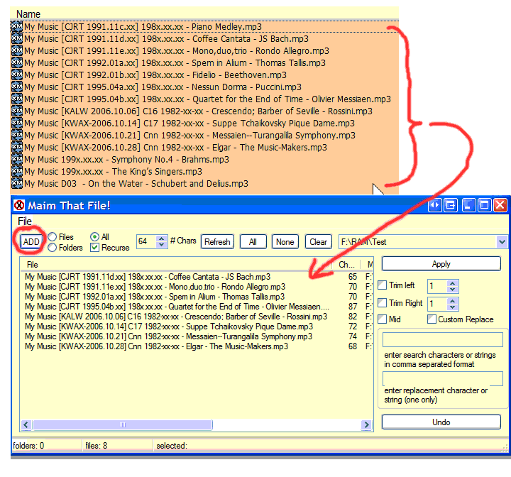

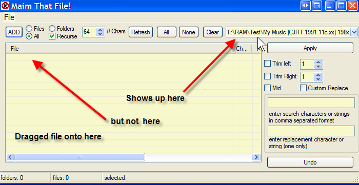

Is it me, or is something broken now?
Can't get file names to appear in the list, but they do show in the drop-down...
Load through 'Add' button leaves the list blank, same with drag-drop.
See?
[attachthumb]

from the drop down list it looks like you added a single file (or dropped a bunch of files) - this is something I've never considered and which may go a long way to explaining things.
dropped or added paths are considered paths to search for files, not actual entries.
I've always operated under the assumption that users would be working with folders rather than individual files, which logically fits with the OP.
If you want to use it with loose files I'll have to look at that further...
and thanks for the feedback (keep it coming!)

You're right I was being dumb and don't want to affect individual files
Drag/drop folder works... BUT I tried d-d only because pointing to a folder using 'Add' does nothing at the moment (did in previously version).

again, 'adding' files works fine for me - try clearing the session and if that doesn't work, WIN+F10 to reload the script

This one
My Music [CJRT 1991.11e.xx] 198x.xx.xx - Mono,duo,trio - Rondo Allegro.mp3
doesn't seem to get 'undone' back to its original name.
I'm using 64 and mid 9,30.

This one
the issue is the comma's in the name (still working on a fix...)

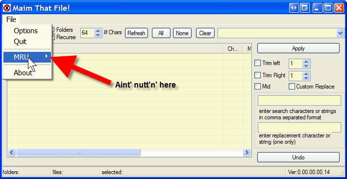

It would be very helpful if successive runs of MTF could remember the previous folder from which  files were loaded.
have you tried the MRU (under the file menu)
I don't see why you can't spend an extra bus trip or two on working to save me 10 seconds
seems perfectly reasonable to me
Alcohol is photoshop, bottled
Yebbut, while that works (here) with successive runs of MTF without closing it, it does not persist from use to use.
So, close MTF, reopen MTF, MTF MRU AWOL.
[attachthumb]

Target
  • Posts: 1,840
did you click on the MRU menu option (it doesn't automagically display)
it's working here
what's in your ini file (curious to know if the MRU entries are getting saved)
