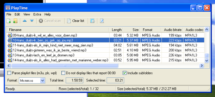

Just tried on a clean install of XP-pro SP1. Dropped a few folders of music (mp3) and movies (mpg), and PlayTime (1.2.6.3) displayed it all without a hitch, and played the files I selected and that are supported by a plain XP install: mp3 and mpg are fine :)
Just for fun I dropped in an album by a quite famous (all over NL :D) singer :P
Must be some other issue bugging TT1 here :-\
/Ton
