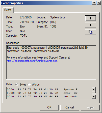

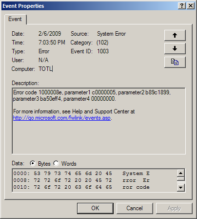

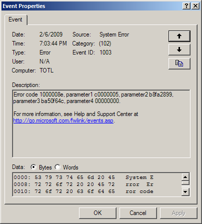

Well, here's what's happened so far.  I don't always get a BSOD after the computer hangs, in fact, I get less than half the time.  But if there is a BSOD, there is no STOP code but the portcls.sys file is always there.  I've attached screenshots of the error windows at the bottom.  i don't know what that means.  So I tried some things last night and here's what happened:
--removed one of my sticks of ram.  after that, one of my games installed fine!  I thought that was it and the problem was solved.  But then i tried installing another game, and it hung immediately.  So problem still exists.  Also, just one time, the computer hung when I tried exiting Kaspersky, but I did it again successfully many times.
--I swapped the sticks of ram, didn't help.
--I did a memory test with memtest86+.  I completed 19 passes with no errors.
--If RAM is not the problem, something else is.  i don't know what else to do at this point.
--40hz, those links you mentioned, I think I've also run across them.  The difference with my problem is that the hangs are always happening during the installation.  Once installed, the games work fine.
Screenshots:
