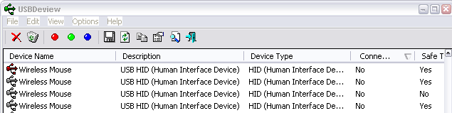

Usbdeview can enable/disable USB devices and it has command line support. It's worth a look.

No that didn't work either. When the error occurs the device is listed as unconnected even when it is physically connected (the multiple copies of the same device in the list comes from it having been plugged into different USB hub ports)
