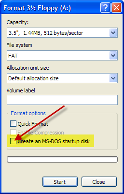

Re: Seagate's Barracuda 7200.11 drives failing at alrming rate?
« Reply #42 on: January 19, 2009, 10:16 PM »
This is what it looks like on my system (formatting a floppy disc):
Note I only ever had Windows XP installed on this system.
The ability to format system floppies was reinstated after the complaints when MS removed the function in Windows 2000.
Alternatively see: http://www.bootdisk.com/
« Last Edit: January 19, 2009, 10:19 PM by Carol Haynes »
