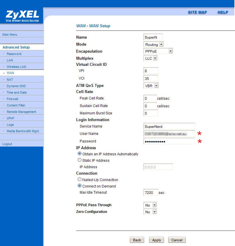

My ISP is indeed telefonica chile, i did try their name as the password with no luck. I dunno what username and password are you talking about.
Your ADSL connection requires a username/password to work correctly, for instance, without it you might not have access to your ISP's DNS servers which will make accessing any web sites quite hard, (as I just found out due to the screw up with my landline and change of ISP).
The only password that the tech guy gave was for connecting to the wifi in the notebook. If you mean the user/password that i had to use before i had the router then yes i do have that.
If you look at the pic, the two items marked with an asterisk are what's required, these are normally different from any dialup username/password you received.

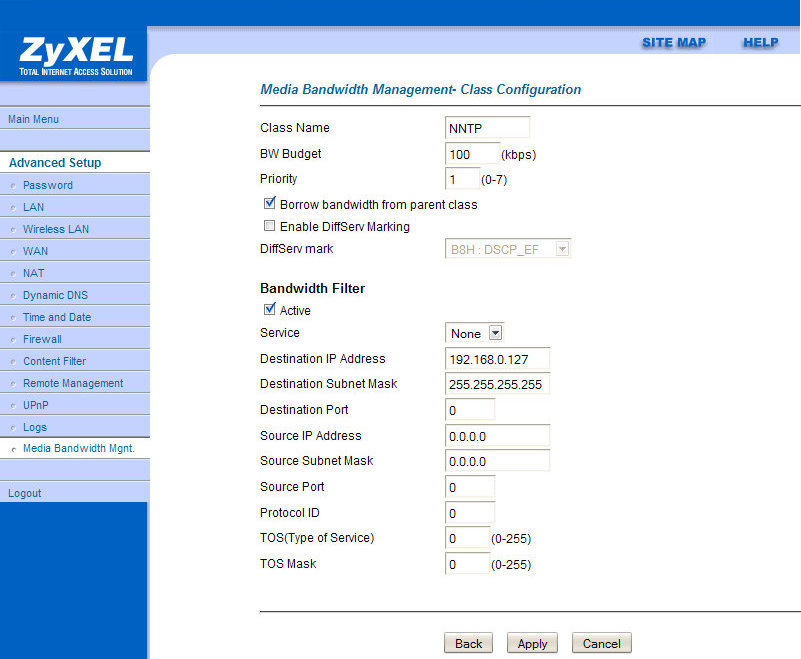

It uses max bandwidth all the time, however, in Media Bandwidth Management I have set that PCs IP so that its Bandwidth Budget is 100kbps and it has a low Priority of 1, which basically means any other traffic has a higher priority and the bandwidth of that IP will be reduced to 100kbps in the event of another PC browsing the web, fetching mail, ftp xfer, etc, etc.
It's also set to borrow bandwidth from the Parent Class, (LAN 100Mbps), so if there is no other traffic it can hit the max bandwidth of 256kbps, (I only have 256/64 ADSL).
The pic below is of the settings for the Child Class NNTP under the Root Class of the LAN Media Bandwidth Management.

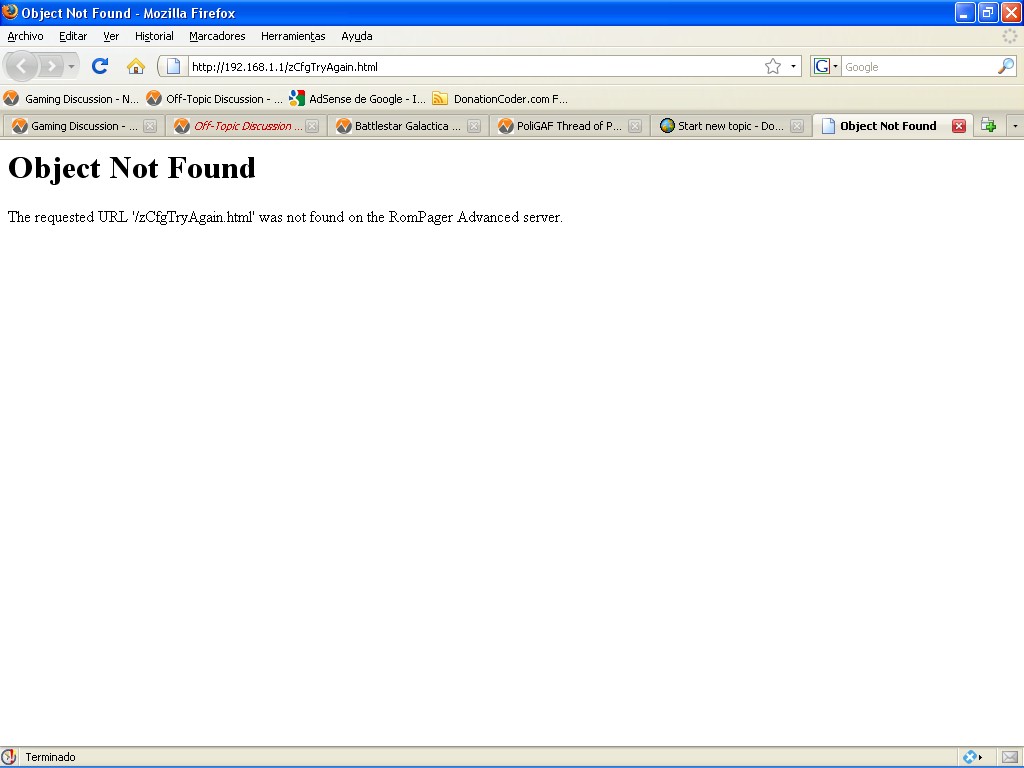

Thank you so much for replying 4WD and good timing too since i have a certain internet problem that hopefully you (and other people too) could help me with, i finally found the router's password which i hope would let me fix this annoying problem. I am just going to repost what i already had written awhile ago, take a look:
Recently i have been having a lot of problems with my internet and my ISP is basically useless since every method that they have suggested has failed. Basically sometimes when i go to a webpage i get redirected to "http://192.168.1.1/zCfgTryAgain.html" and get the Following message:
Object Not Found
The requested URL '/zCfgTryAgain.html' was not found on the RomPager Advanced server.
if i try any other site is the same thing and i also can't download anything so for all intents and purposes i have no internet. This used to happen before but for only minutes however recently it has lasted for hours even i reboot the PC and the router. After doing a google search the only thing i could learn is that the "http://192.168.1.1/zCfgTryAgain.html" is shown when the DSL line is not up which doesn't me help at all. My router is a Zyxel P-660HW-T1 v2 and i have the password for it so i was wondering if any of you could help me in figuring out the problem. I have also attached a screenshot showing all of you what i see when my internet is down.

When it happens access the router's interface and go to Maintenance->System Status, under the WAN Information you'll have your IP, netmask and VPI/VCI settings - if you haven't, the router hasn't connected to the ISPs equipment.
You can also go into Maintenance->Diagnostic and do an ATM Loopback test, it'll say it was successful if there's a connection.  The ATM Status should also show something besides all 0's, eg. your rxRate and txRate will be higher than 0.
Also check the Upstream/Downstream Noise Margins - if they're too high then either you're too far from the phone exchange or your phone line is noisy due to crappy joints, (trust me - I was a telecommunications tech for 19 years, even though you may not be able hear any noise on a normal phone call it doesn't mean it isn't there, it could just be affecting the frequencies that ADSL needs).
I live pretty close to what was the 7km limit of ADSL and I know I'm on copper cable all the way.

I think my ISP is in Santiago , Chile which according to google maps is at a distance of 120 KM. I have no idea if these results are good or bad tough, probably bad considering my bad connection.
That's their head office - where they hide, charge you money and provide little support.
If your internet connection was provided from Santiago you wouldn't have any internet at all - the maximum effective distance at which ADSL1 can be used reliably is about 7-8km.  ADSL2(+) can extend that a little but not much.
Your ADSL connection is provided over your phone line from the local telephone exchange to your house - somewhere in your town there will be a rather drab building, (or possibly in the back of the post office if the building is big enough), marked Telephone Exchange.  Someone around town should be able to tell you where it is, (Police, Fire Depart., etc).  When you find it, measure the shortest distance between it and your house on your bike or in your car, (the actual distance the copper cable runs will be longer).  Or just ask the company who provides your phone service how long the cable run between your house and the exchange is - you might get someone helpful who'll tell you.
Depending on how far away it is will help determine where the problem might lie, (eg. if it's <3km then the fault is possibly crappy wire joins or faulty equipment).
You could try unplugging the phone line from the back of the router 3 or 4 times to clean it's connection, the same where the line from the router plugs into the box on the wall.  Plug/socket connections tarnish over time and that can introduce resistance into the circuit.
It could be that the ADSL filter itself has developed a fault or that any joins along the length of cable from the box on the wall all the way back to the telephone exchange have gone high resistance
My Router lights have always been green, i don't think i have ever seen them being amber. They flash tough. Oh sometimes the DSL and the internet lights would be off.
My fault, I assumed the 660 series would have the same colour LEDs throughout the different models.
The router is connected to a little box on the wall in my room, the box has a wire that goes to another other room where the only phone of the house is located. The box (i dunno how to call it) has a slot where you can put another phone line and that's pretty much what i can tell you about the box.
Sounds like a central ADSL filter/splitter, same as I use.
Sure tomorrow i'll send you screenshots of the router's configuration pages, hopefully you were joking about that stuff.
And thanks for helping me out 4WD.
