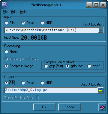

In that case:
SelfImage: http://selfimage.excelcia.org/

Thanks for the suggestions 40hz but I also looked at SelfImage, the problem with that is it requires Windows.
So to get the use of one program I'd have to create a minimal BartPE which would still end up being well over 100MB in size, (the Aspire One has no ODD or even HDD, so the space would have to come from the 2GB flash) - rather a bit of overkill for something as simple, (relatively speaking), as a drive imaging program.
