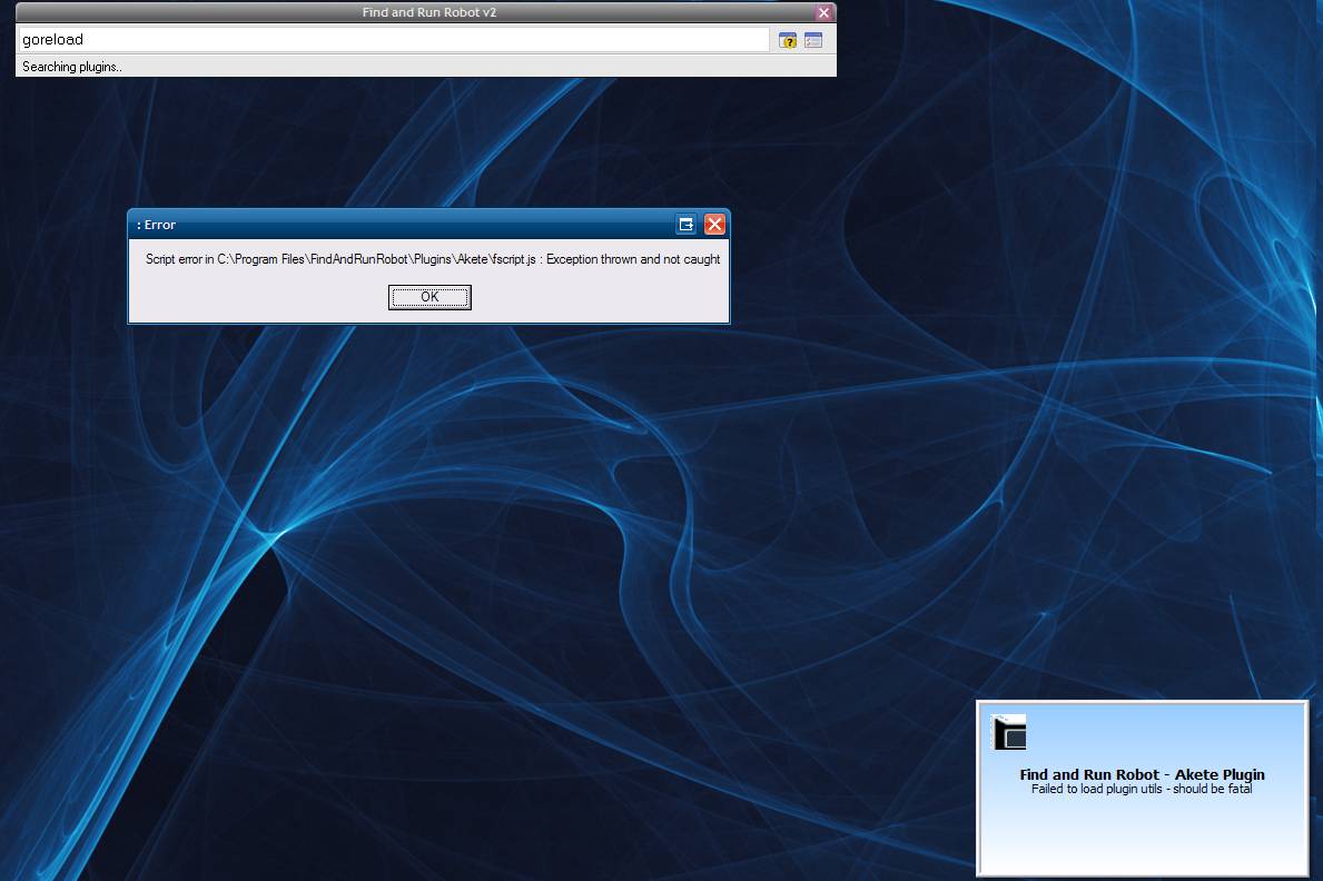

I'm afraid it's a 'doesn't' for me. See attached screen shot.
[attachthumb]

Thanks for the report.
Hmm...May I ask how you performed the installation of the plugin and what version of FARR you are using (I'm using 2.45.01)?
FWIW, the new plugin has some code split out into a separate file so upgrading is no longer a matter of replacing fscript.js -- on the off-chance that that's what was going on :)
Edit: I managed to reproduce the error -- investigating now :)

Terribly sorry -- completely my fault.  Sorry to have wasted your time.
I have uploaded a version with a work-around [1] -- this time I tested the installation from the downloaded file (like I should have done to begin with!).
[1] I had code for determining the directory of the plugin that was specific to my atypical set up -- as I understand it, a future version of FARR should make the work-around unnecessary (though I'll need to update the plugin to make use of the feature).

Thanks. Works perfectly now!
