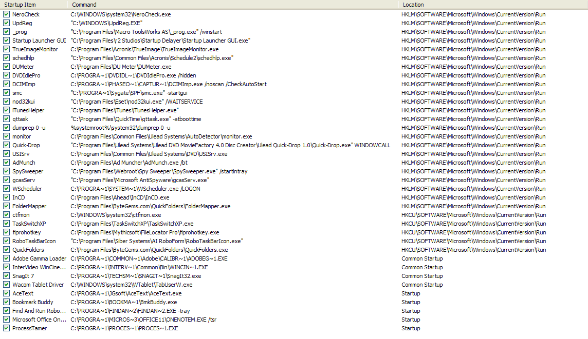

This is what I have in terms of startup apps and services curently ... nothing seems particularly odd:
« Last Edit: November 29, 2005, 02:02 AM by CarolHaynes »

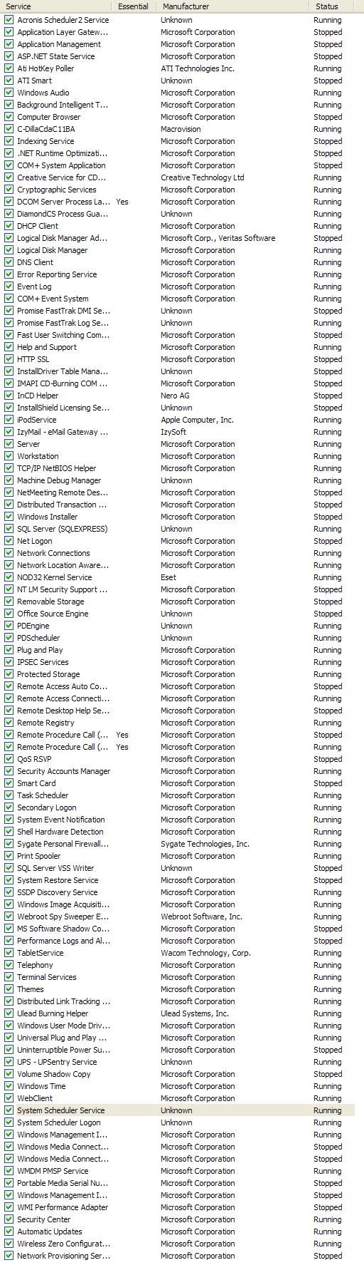

I have also downloaded SpyWare Doctor as it had good recent reviews (since that is supposed to detect and remove K.EXE keylogger as well as worms/trojans). It too came up with nothing ???
There are no suspect services or processes running or listed this morning. I guess I had better just keep monitoring the situation everyday - and after I browse the web just in case something really sneaky is lurking that no one has met yet!
