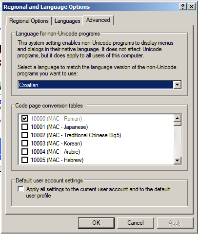

I don't know about you guys, but this solved all of my language related issues with FARR (and some other apps too). Go to Regional and Language options in Control Panel - select the Advanced tab, and under the Language for non-unicode programs select your language. Press OK.

now that is an interesting discovery!!

Interesting, yes. Windows is full of little things like that.
However this didn't change anything to my character problems...

Have you tried setting font overrides in FARR? It is in Settings - Font overrides. Be sure to select script that suites you. I chose central european. Although I've tried playing with theese settings now and got no difference, but try it anyway.

Thanks skajfes!
Unfortunately it still doesn't change anything...
I cannot really choose any other option than "Western" anyways... Since I speak French.  :)
