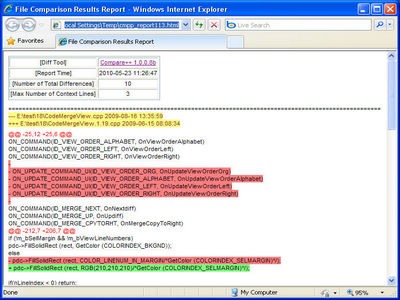

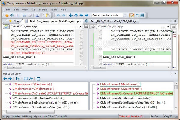

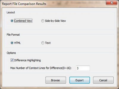

You can try Compare++. In the file comparison window, Select File > Report and set "Max numbers of context lines for differences" to 0, you can extract only different lines.
Here is a demo
