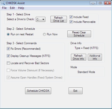

See if CHKDSK Assist AutoHotkey Script could locate and fix the errors.

Philb666: I fail to see how that tool can do anything that the regular commandline can't? The "Locate and recover bad sectors" should be the same as the /R switch, or clicking the "scan for and repair bad sectors" checkbox in the driver properties checkdisk thingy.
You are correct, f0dder.
