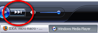

I need to record and play a macro, but all the programs I have found (many!) can do way too much for my need, and will confuse me more, than help me. I only need this one 'Windows Media Player 11' "next >"-button to be clicked every twentieth second for maybe half a day. That's all. Like a micro-"ClickOff"

Click this WMP button every 20'th second:
That's it.

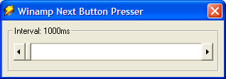

I made a Winamp-specific thingy, doesn't need to change shortcuts or anything.
Binary and VB6 source: WinampPresser.rar (24.1 KB)

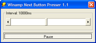

NEW v1.1
* added pause button, and fixed a little scrollbar button
Binary and VB6 source: WinampPresserv1.1.rar (23.9 KB)
Hope you like it.

Edited:
will it take much to give it a pause / disable -button, please?
