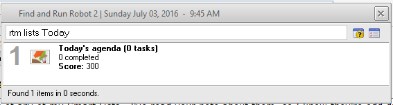

I can't get the plug-in to show the contents of any of my Smart Lists.  I've read the note about them, so I know they're odd ducks, but it sounds like they ought to work if I've got the option for them checked, which I do:
When I try to use a Smart List, here's what happens:
1. The list shows 0 tasks.  I think that makes sense, given what you've described in your note:
2. When I select the list, it fills in the command line with what looks the correct syntax:
3. When I hit enter, instead of going and fetching the list and displaying its tasks in FARR like it'd do with a normal list, it opens my browser as if I were searching for rtm tasks /list:"Today's agenda"
I know that the Smart List I'm using here as an example has a single quote in it, and I thought that might be the problem, but I tried with another Smart List without one, and it did the same thing.
Can anyone tell me what I'm doing wrong?

I don't think you're doing anything wrong. Smart list support seems to be broken in the FarrMilk plugin. A quick search through the RTM API forum indicates that smart lists are still badly supported in the API so I'm afraid I am not sure I can fix this easily.

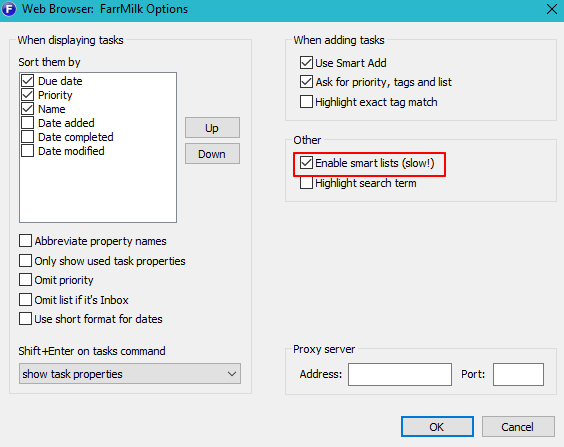

I am using the ID of the smart list, which does not seem to work. Can you try your query in 3. with only the list_id, but without the filter? And maybe also the list_id with an empty filter? Using only the filter seems to work though, I found this as a solution in the dev forum (and according your test also the filter and the list_id together). I did not keep track of the filter, so I assume the introduction of the filter and the respective change to rtm.tasks.getList is when the functionality broke in FarrMilk.

Hm, you are right, it does indeed work. I did not change a single line of code related to smart lists and it seems to work with my current build. How strange :tellme:
Could you try this version please?

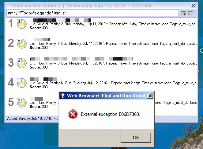

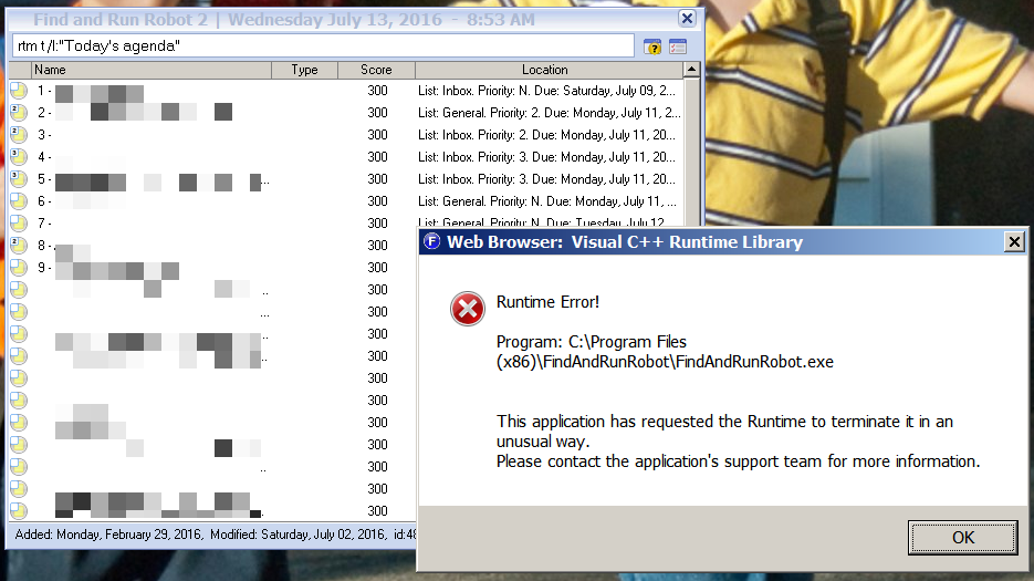

It installed and ran this time, I'm getting errors.
In this screenshot, I clicked on entry 5:
In this one, I hit PageDn to see all tasks, then hit the down arrow to get into the list:
At that point, FARR force-closed.  Could this have to do with my running 64-bit Windows (7 Enterprise, SP1)?

I'm not sure. I'm running Windows 8.1 64-bit and it seems to be working fine. I would assume it should run with 64-bit Windows 7 as well though. Does it matter which of the tasks you click on in order to make it crash? Does it crash with 1.1.3 as well?
I have an old laptop somewhere lying around that I think still has Windows 7 installed (not sure if it's 32 or 64 bit though). I'll try later with that one.
