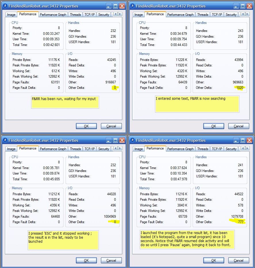

1) when I run a program using F&RR, it does go away in tray when I press a number key, but it doesn't stop searching (or at least using the disk) ; moreover, if it DID stop using the disk before i pressed a key (e.g. I pressed ESC, so it stopped, and then I press a number key), it starts using the disk again.
I don't know if I'm very clear, I'm not a natural English speaker  ;)
The phenomena always happens, whatever the program launched.
I attached screenshots of Sysinternal's Process Explorer window showing the IO delta generated by F&RR, along with comments.

what a nice post - and i learned something new about process explorer that will be quite useful..  :up:

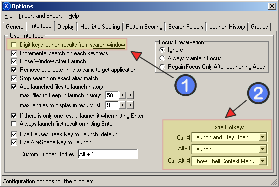

i will fix this behavior asap (i'll try this weekend); in the meantime you might want to disable auto-launch on digit press and configure it to launch on like alt+1 or ctrl+1 and see if that fixes it.

Well, I tried what you suggested and it works ; I disabled the 'digits keys ...' option and enabled the launch using the CTRL key. And now, it works and doesn't consume any unnecessary disk time !
Well done, M. Mouser  :Thmbsup:

i actually have mine set like this too, and am thinking of making it default, just because it then also lets you search for files with numbers in them..
