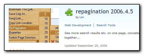

you can use Repagination to combine all the pages into one and then save. just a thought. :)
• https://addons.mozilla.org/en-US/firefox/addon/2099

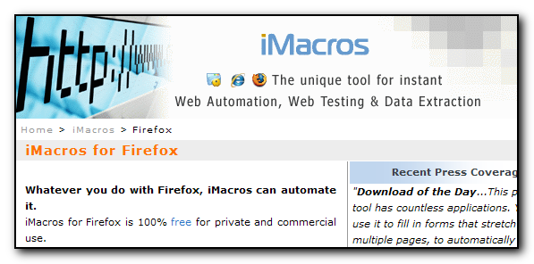

i totally forgot about this - iMacros for Firefox. :)
• http://www.iopus.com/imacros/firefox/

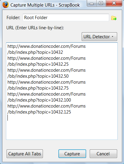

Scrapbook (https://addons.mozilla.org/en-US/firefox/addon/427), maybe?
If the sequential pages have some sort of numbering rule in their URL (most do, I think), then you could copy the starting URL, duplicate it as many times as required in an editor, change the numbering as required for each URL (with 400+ items, I would probably do this step in Excel or something similar), and ask Scrapbook to down them all in a folder.
I did a small test with one of the long thread on this forum:
[attachthumb]

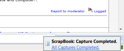

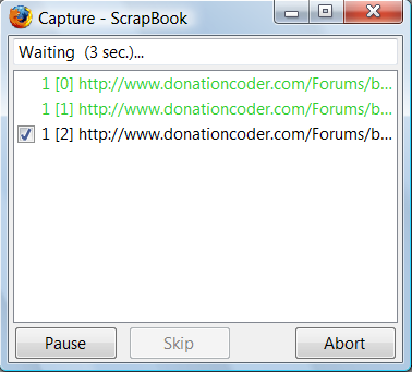

If you use the first method I mentioned (giving Scrapbook a list of URLs to save), it saves the web pages in the background, meaning it doesn't load the pages into Firefox. There's a small pop up showing the progress:
It saves one page at a time, with a small delay (a couple of seconds) in between, so it won't overwhelm the server. You may safely ignore the progress dialog (which would take some time if you give it a long list) and continue to use Firefox.
When it's done, the progress dialog goes away and another small message box pup up from the lower-right corner telling you "capture completed".
