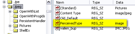

Having removed a couple of dozen programs yesterday I suddenly realize that the Explorer > folder view > details > column 'Image Dimensions' have stopped working. It is there, the column, but is not showing any image dimensions, no matter the extension.

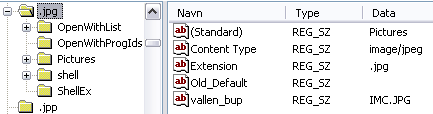

The only solution that I know of is  to make sure that HKEY_CLASSES_ROOT > .jpg >  Value: 'PerceivedType' > String Data: image is checked (for each file type) - and this is a problem, because while the brother .JPEG have this listed okay, all of my images are .JPG, and for .JPG there is at the moment no 'Perceived Type' at all. I have absolutely no idea about how to both create a new AND tell the string data to be 'image' - the default seems to always be four zeros.
Do you know HowTo fix it and give me back my 'Image Dimensions' in XP's Explorer?
Or do you know of some (freeware) program that will (also) solve this problem of mine?
--- JPEG is listing "PerceivedType" but is not showing any image dimensions, either:
--- JPG is not even showing the "PerceivedType":

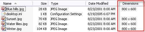

--- How it should be:
--- and how it is:

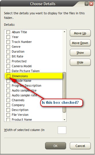

Is the "Dimension" box in the "Choose Details" dialog checked?
Re: HowTo get back 'Image Dimensions' in Explorer?
« Reply #2 on: August 24, 2008, 09:33 PM »
- yes.  [attachimg=#]

Try to (re)register shimgvw.dll (Start --> Run --> type regsvr32 shimgvw.dll in the box and click OK (A message should come up with DllRegisterServer in shimgvw.dll succeeded). If that fails to fix the "Dimension" problem, copy the following to notepad, save as imagefix.reg file and then double click on it to merge.
Windows Registry Editor Version 5.00
[HKEY_CLASSES_ROOT\.jpg]
"PerceivedType"="image"
« Reply #4 on: August 25, 2008, 09:56 AM »
Thanks a lot for your efforts, Phil  :up:
However, it seems there must be something different wrong. First, the shimgvw.dll did register okay, but made no difference. Secondly, PerceivedType is now showing up nicely, but made no difference, either.

You see, the problem is still there: I have the column, Dimensions, but they are not listed:

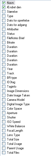

- I had to see if XnView had come up with new features I didn't know about. XnView is good, it is very good, and fast, but it still doesn't add Image Dimensions to Explorer. Yes, it will tell the dimensions if you right-click an image, but that is not the feature I am looking for.
It is a little strange to me how easily I can have these columns in Explorer tell me just about anything, but the dimensions.
clickable thumb:
As you can see, I already have "Image Dimensions" listed, but it is not working. However, it used to work, a month or so ago, when I had another program / DLL installed / registered. Back then I had two "Image Dimensions" listed, but only one of them would work. I kept the wrong program!
So:
"What programs will add "Image Dimensions" to the Explorer columns?"
:tellme:
