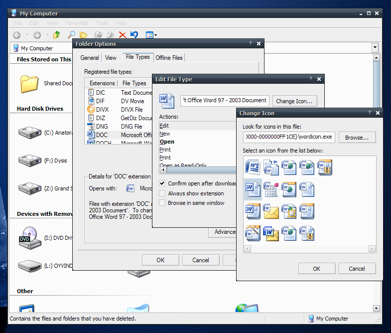

Did you reboot after rebuilding the cache? If not, it's worth a try. Also, as Curt mentions in his post you could try taking a look here (my screenshot is of the *.doc filetype but the same applies to any other):

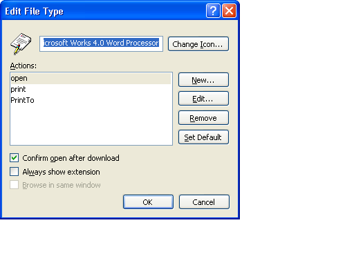

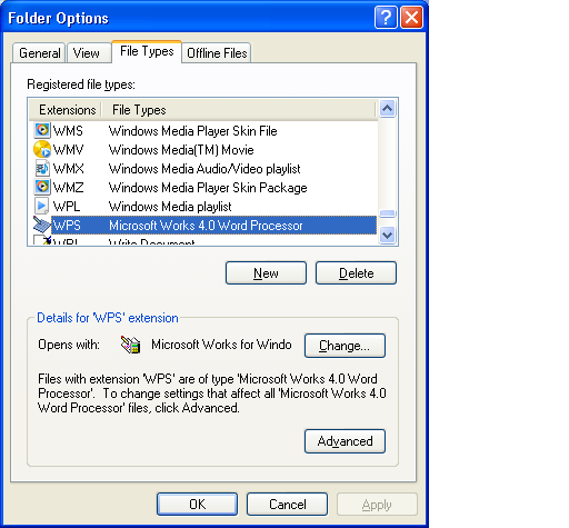

yes I did try a reboot but that didn't help.  I also check the file associations and it was set to a works 4.0 word processor type.
she does have some word docs (not many) so it would be easier for her to tell the difference by looking at the icon.

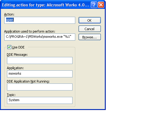

when i click a .wks it opens up with works.

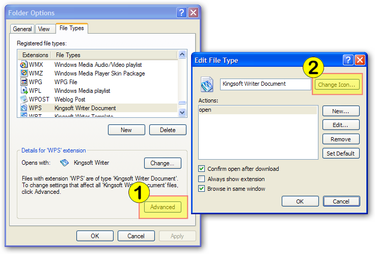

several applications seems to have a preference for the WPS extension. since f0dder has already mentioned about changing within Windows and that didn't work for you (see pic). maybe WAssociate could be of help here.

nice screenshots lanux, what incredible screenshot program did you use to make those?

here are some screenshots showing file association for wps.
Seriously, I thought and wondered exactly the same thing!

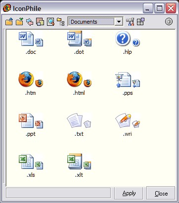

Here's one more to add to the list.
Iconphile review at freewaregenius.
